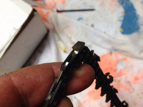

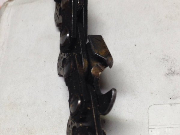

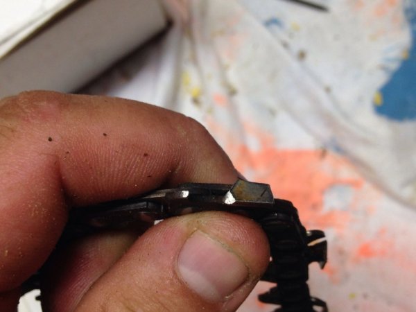

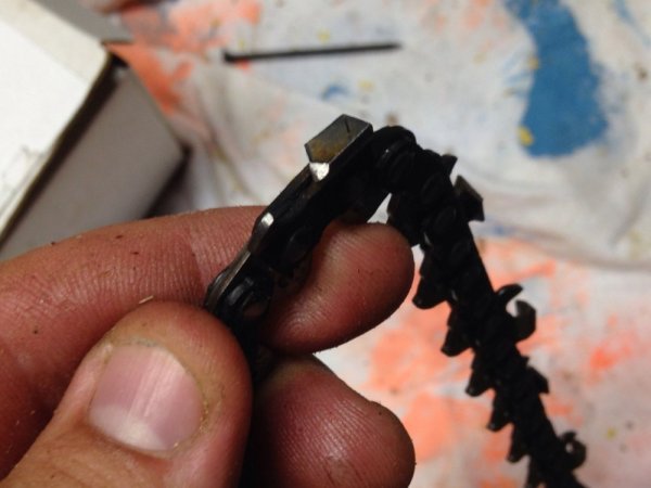

    I picked up a load of oak today. The guy asked me to try to sharpen this chain. It like he hit something hard, all on the same side of the chain. I'm only set up for hand right now. How do I go about this? Anything special? Thanks

    Send it to Pete. It needs to be filed back far enough to get past the damaged part, and then the rakers will probably need to be taken down. It's a lot of material to take off by hand.

    I agree...I've had a chain look like that..hit a big azz nail in the middle of a trunk (tree must have grown around it) an chewed up every left hand tooth. Like Jon said - need to take both sets of teeth back past the damage...Pete's yer man.

    Tell him to buy a new one...and have that one touched up later . When that chain is fixed...it will be down to 50% or so anyhow :(

    The 1st few passes with the file will be fun. But I don't do anything special, just file till sharp and set the rakers.

    Could go at it with a dremel :dremel: with the right size stone or bur then finish by hand

    Ill gladly clean it up for ya. Thats a lot of damage for a hand file... Your gonna really want to grind it to get it to cut right again. The rakers will have to all be set to the depth of that tooth which means all the teeth need to be taken back even. Its a lot of work and your going to lose a good portion of the chain in the process.

    Pete's definitely right on this one. I wouldn't waste a file bring that one back, that one is going to need a lot of meat taken off of it! Been there done that, it stinks... But it happens! Cut a nice piece of pink quartz with a new ms261 one time, didn't even see it comin' :eek:

    Hmmm. Problem here is you would have 1/2 the cost of a new chain racked up just in shipping by sending that one out. No big deal tho if you have other loops that need sharpening.

    Maybe a local shop could grind it for you and you could set rakers and touch up the teeth by hand?
    Unfortunately I don't think the post office could get that chain to Pete or I and back to you by Fri without some special ($$) handling.

    This is why I bought a USG. Folks bringing in stuff that look like it had ate concrete etc. Set up even them all up good to go for next round. Just to much time to fix by hand at $5 a chain.

    Heck, that's cheap even grinding them. Chains that look like that are extra work even on a grinder.
