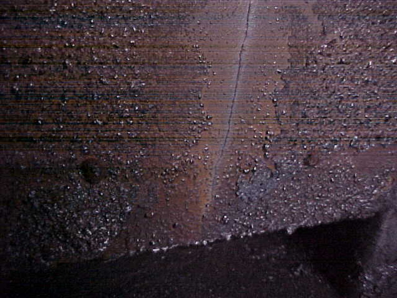

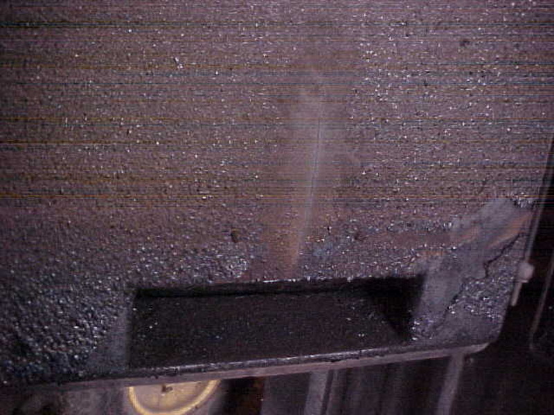

    I have a Central Boiler Classic SCL 5648SB Titanium enhanced Stainless steel Boiler. Put it in myself in 2002. Pretty particular with my stuff and you can see the install via the picture links. Completely cleaned and inspected the stove as normal and checked the PH and everything was fine. I get inside the stove every year before firing it up and get everything out. Ran the stove about a month and noticed a crack has formed on the back of the door and extends to the damper opening.

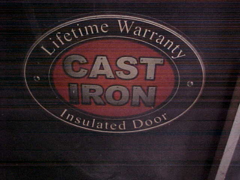

    I burn only dry wood and I have my Boiler inside a building I built for it and my wood is in there as well. Keeps everything dry and well as me when filling and maintaining. I searched and found others had had issues as well and their dealers had replaced them as the door has this on it.
    I called the dealer I bought it from and said I had a crack and need it replaced under warranty. He then told me it was 17 years old and it would have to be "approved" before they could do anything. I needed to send him pics, which I did. He said their " Lifetime Warranty" is for manufacture's defects only. (Here we go.) Emailed me today and naturally they say they won't cover it because it was NOT defective. Their options are for me to pay to have someone weld it or buy the newly designed door for over $300.00. I guess they have moved away from cast iron and have an all steel plate door now?
    If any of you have one I'd appreciate a picture since I'm left holding the bag on it. What have others done. I've repaired a lot of cast iron stuff with preheat and high nickle rod but have not repaired anything that has the heat cycles that a stove door would have. I'm wondering if scabbing a plate with an angle to the damper opening would be an option. Maybe bolt on with furnace cement behind but don't know about the differences of plate steel to cast. If the drilled holes to hold the plate in place would cause issues or not is another consideration. Another option might be to cut a whole center section out and create a new damper opening to attach the opening mechanism to.
    Obviously I'll have to keep a close eye on it if it opens up enough to start causing an overheat condition if air can get in when the damper is closed. Want to see if I can make it till the Spring so I can take it off and take my time with it.

    Just a heads up when it leaks air like that the door will get hotter . Might want check surface it buts against for uneven surface . Chances of replacement in 17 years . They will pro rate it .

    It just stings when you've looked at a door that says "Lifetime Warranty" in huge letters across the whole face of the door and find out it is just a marketing ploy. I hope they have taken that off the new ones. I did research and seems a lot of people had issues with them and they all got them replace. Never found one saying otherwise. It seems like you get punished for yours not cracking early so the excuse of age can be used. It was explained to me that casting issues is what the warranty was for. Open voids and such. From being in the metalworking field those should have been caught before they were even sent out by xray. We do that with welds for high pressure systems and problems are found BEFORE they are sent out or put into use.

    If you want to play the word game it should say "Limited Lifetime Warranty" then. Design issue and manufacture's defect is the same thing to me. A company designs something that will withstand what it was designed for and if it comes to where it doesn't, it is on them unless abuse/neglect has occurred. I've only added water twice to the stove in 17 years and even then it was just barely to the low mark each time. That alone should rule out overheating questions. They are the ones that decided to put the words on the door to give an impression of standing behind it completely. I guess it's my fault for not assuming it meant basically nothing more than a sticker.

    Yeah, the chance of lair leaking in and affecting temps of the stove are realistic.
    Maybe some high temp refractory cement applied to the cleaned cracks will limp you through the season? Or high temp silicone?

    What I may do is find the end of the crack line and drill a small hole there. I can try to slow further damage maybe. Then plug that hole with some furnace cement. Drilling like that normally is the best thing you can do to try to stop it from continuing. Looks like the inside of the new style door has a standoff panel. I'm guessing that is to tone done the radiant heat from the fire? I'll post a pic tomorrow when I get time

    I understand your point, but a 17 year run on a product that sees so many heat cycles is darn good IMO. The lifetime warranty on the original design was probably for a life of 15 years.
    Stop drill the end of the crack, clean the interior surface really good and put a layer of insulating refractory on it. Then forget about it.
