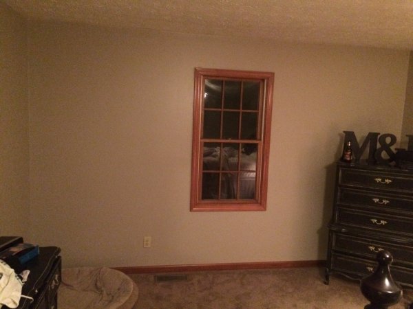

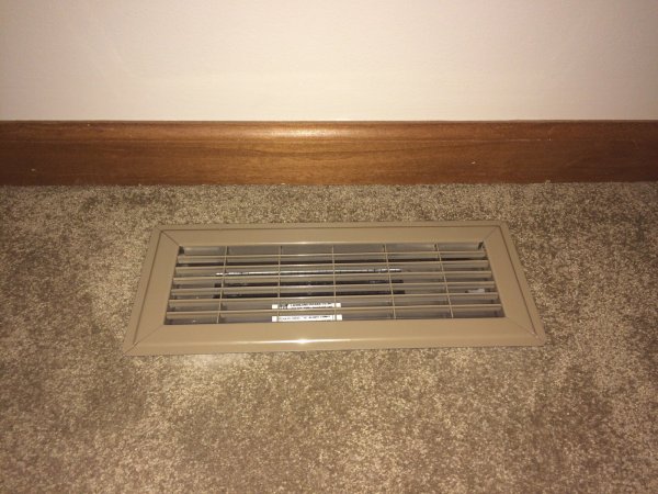

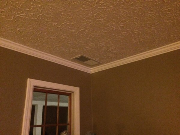

    Been considering this for a while now and finally did it. I bought a Tjernland RB12 register booster fan for the upstairs room above the stove room. I also installed a ceiling register in the stove room as the intake for the register booster upstairs. The fan uses the floor joists as a duct or chase for the air to flow thru. First test tonight but seems to be working perfectly. I read 82 deg downstairs in the intake register and 79 deg upstairs in the register booster!! Should help keep the stove room from getting crazy hot and help upstairs stay a little warmer. I'll report back as I use it more.

    I'm my 1880s Victorian farmhouse I had 2 gravity type vents like yours Trilifter7 , inbetween two floors. I know in my case they may be grandfathered because of them being original to the house but I was bagged on one of them in my stove room during a stove inspection in 2008. I know they are illegal in today's building code but can be allowed with a fire door. So the inspector asked me to install one or close it off as a fire hazard. I ended up installing a fire door on the stove room register in order to keep the vent. Just wanted to share that because some folks might not know.

    You can barely here the fan. It sounds like a standard register blowing air when the heat or ac is on.

    Here's a better pic to show where it's at in the stove room
    In relation to that pic the register booster upstairs is about 10 feet back towards the middle of the room along the wall so it stays in the same joist chase. The floor/ceiling joists run from behind me in that pic toward the stove.
