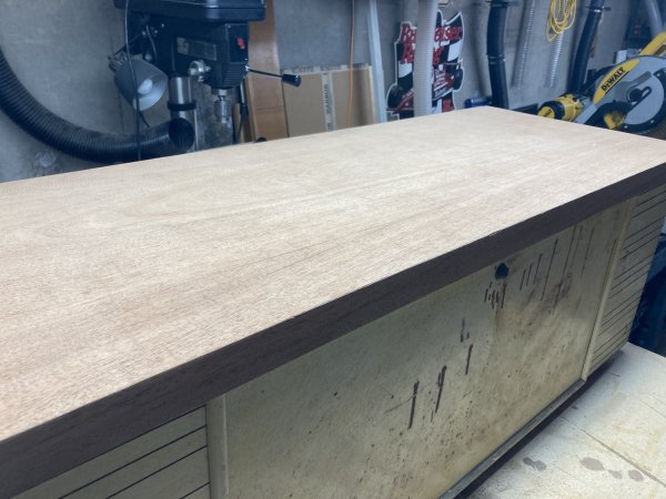

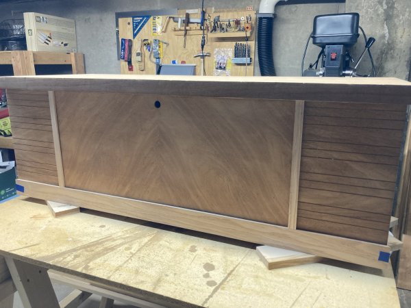

    IMG_1846.jpeg IMG_1849.jpeg IMG_1848.jpeg My wife acquired her mom's old cedar chest that was a wedding present to her back in the 50's. It had been in her basement and over the years seen its share of floods and damage related to it as well as a lot of wear and tear.
    It was mfg. by Lane and the SN# comes back as 11/11/1955 date. It was originally a yellow color that is just plain ugly and nothing we would ever put in the house.
    Since it has no true value, I figured lets at least get it looking like something she could use.
    So ; off we go with the belt sander and 60 grit , then 80 grit on random orbit sander , 150 grit and 220 grit. Amazing that the actual veneer under the paint looks great all things considered , the actual way they lined up the grain is nicely done.
    I had no choice other than make some trim pieces and cover the bottom couple inches to hide the water damage and missing pieces along the bottom , I made pieces to replace what was missing but there is no way to do anything else since it is covered with veneer ; so trim it is.
    The legs were shot and one side completely missing , I copied what I had and made some new legs.
    Sorry but I am not the best as far as taking pictures but here are a couple.
    One is just the top sanded but the bottom is still the yellow , the second is after it has been sanded and trim just taped in place to give me some kind of direction as to where to go from here. I also have pieces cut for corner trim not shown.
    I will try to make sure I get some better pictures as I move along.

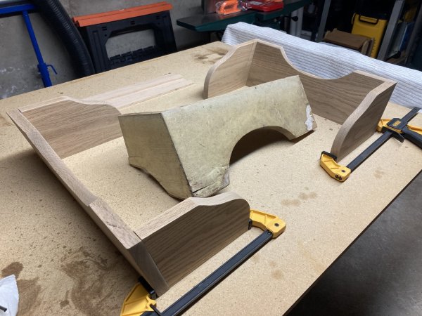

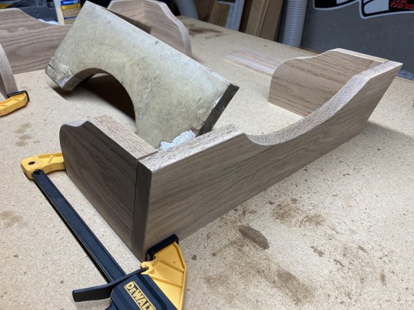

    A quick set of legs off what was left from the old one has a pattern from a piece of oak ahead, laying around
    I’ll glue it up and drill some holes for some hidden screws from the bottom over the next couple days IMG_1853.jpeg IMG_1854.jpeg

    No, that is the original veneer that was under the ugly yellow
    I started with the belt sander to get most of it off and then finished off with the random orbit, 80, 150, and 220
    The original veneer underneath was actually done really nice. It’s a shame they would ever paint that
    I had to add the trim to hide the water damage on part of the bottom and made a new set of legs, there was only one of those when I got it
    I’m going to leave the back and the inside original. The back is cedar and not covered with veneer so I will leave it.
    Try sanding it. You have nothing to lose and might be surprised what you find underneath.

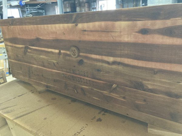

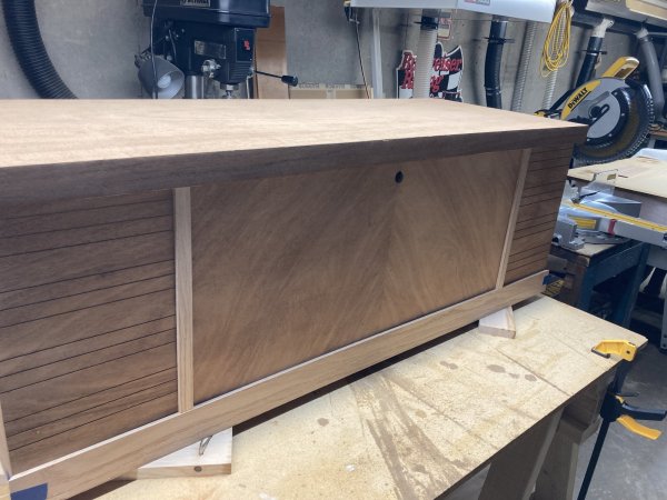

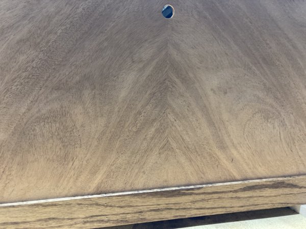

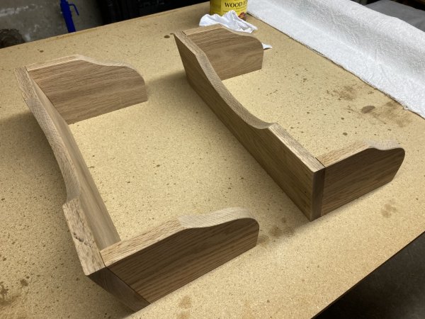

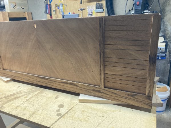

    IMG_1866.jpeg IMG_1865.jpeg IMG_1864.jpeg IMG_1863.jpeg Eckie
    here’s just a couple more of what I’ve done so far
    You can see in the one picture that the veneer was actually nicely done. It’s a shame it was covered up with yellow paint, and there’s one of the original back I’m not touching that
