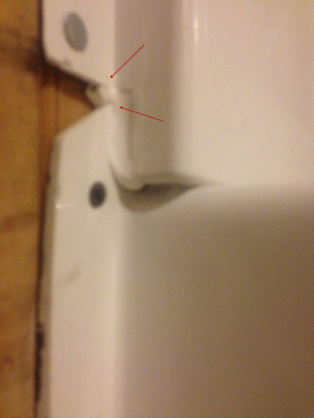

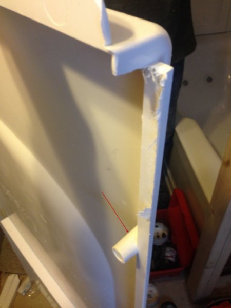

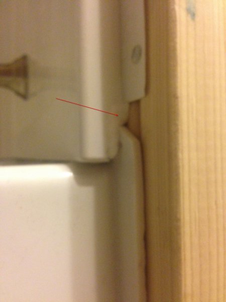

Hello Just updating the whirlpool, going from a Kholer cast iron with brass jets to a new Juccuzzi with the plastic jets. Since it has a nice 1" high tile lip, the caulkless tube surround with no corners seams to fit perfect. The SwanStone is nice, in fact we ordered it, but all the cutting and calking for the shampoo rack and tight corners require cement board behind it, in case it leaks water! http://www.theswancorp.com/index.php?prod=503 Also bringing the swanstone down to a shower pan or tub tile lip is a BIG issue. Furring the wall and bringing the cement board into the lip is impractical so a vapor barrier must be used and silicone the back of the vapor barrier to the inside of the lip is recommended but does not sound durable! See > > http://www.johnbridge.com/vbulletin/showthread.php?t=43323 Swanstone states there must be cement board behind it and Industrial Super calk in the corners. Very expensive caulking that will not mildew. The Sterling 3 piece system from Lowe's is an acrylic molded interlock system that is caulkess and does not required cement board behind it. http://www.lowes.com/pd_89229-721-71224100-47_0__?productId=3124623&Ntt=bath tub wall surround&pl=1¤tURL=?Ntt=bath+tub+wall+surround&facetInfo= Therefore this 3 piece acrylic system below with the rounded corners just seems like it really holds water. I really like the engineering on this. Rounded corners and interlocking that gets tighter as it is pushed down! The 1" tile lip and the surrounnd that overlays it seems to be the best system I have seen. To make the Swanstone this water proof seems to be impossible at any price! BTW. The 1/2" plywood floor flexed every time we walked in. 62 split entry home. So we put 3/4" interlocking titanium treaded plywood over the 1/2" event under the tub and then 1/4" Hardy board cement board under the tub skirt and all over the whole bath for a good base for the porcalin tile floor. Any comments or suggestions?

Hi Smoke Show What are you confused about? I was thinking of installing SwanStone solid surface, but cement board and caulking is needed to seal it up. Then I heard about the caulkless tub surround system and was wondering if anyone tried it. I found someone did on the other site and it worked out extreemly well. What is your experience? Do you have the old tiles, or solid surface or the new well engineered acrylic surround? The pics in my post show how the grooved seams in the enginered acrylic system fit together tight!
