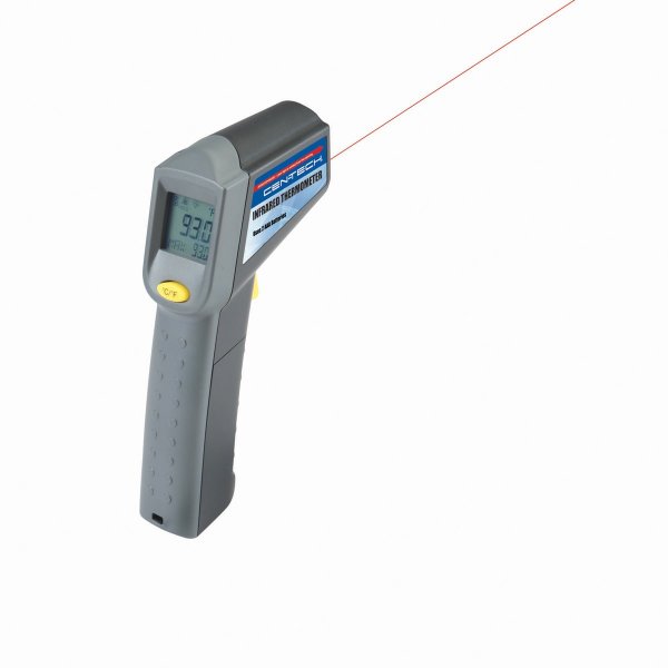

    A better way is an IR gun. Harbor freight has a good one that is not expensive and they can be very helpful.
