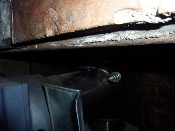

    That may have been me posting about the WS cat probe. Even though it doesn't give a true cat temp, it monitors temp at the flue exit, and I just run it up to 900-1000, cut the air to hold there for 10-15 minutes, then close the bypass. Reliable light-off of the cat every time. I can't look at the front of the dial since it is enclosed in the fireplace. I can see it using a mirror, but I instead have a paper-clip marker at 1000 on the dial so I can see where the needle is in relation to that temp. On my rear-vent setup I also have a surface thermo lying on the tee snout, and could just as easily use that alone since it pretty much parallels the probe. If you wait for the stove top to hit 250, as they recommend, you'll be burning up more wood than you have to.
