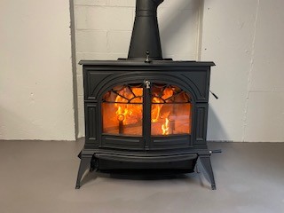

    Anyway - here's some pictures of our basement install. There's an even longer story as to why there is a Class A chimney aside of my multi-flue chimney. Stop by sometime on your way to ACTUAL CAPE COD and we'll share a bourbon and tell stories.

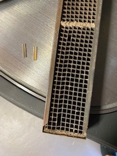

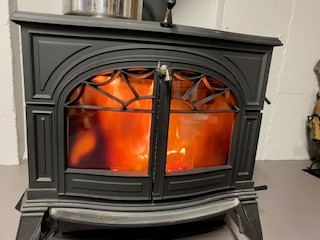

    I wanted to update as I took the catalyst out recently and see that it has gotten worse. Picture below.
    As mentioned this is my first season, so admittedly lots to learn but things seem to have been going "decently" from my unexperienced but well read brain. Couple facts here to help baseline your opinions and feedback: Wood is red and white oak which has been minimally seasoned 2 years with a max of 4 years stacked and under top cover (we also have a regular fireplace on our 1st floor and I had a ton of wood). I just ordered a moisture meter so I can look at that more closely but I'm expecting (hoping) to see <20. My general operation is to light using top down and allow the firebox to fully engage and build some embers before closing bypass. STT is typically 550-650 before closing bypass (manual says once STT says 450 close down, but I have found this to be too early and too cool for Catalyst to light off). Reload currently is happening 4-6 hours with about 4-5 splits (larger in first, smaller on top). After reload, running stove with bypass open and primary air between 50-100% open for about 20 minutes, then closing bypass if flue temps and STT are up. I'm only burning on days when I am able to work from home and pay attention. So typically lighting a fire around 5-6am, with a reload around noon, then letting stove go out before bedtime (8-9pm). I'm not burning overnight as I'm just not experienced enough and the oil burner can take over from there while we sleep at a cooler temperature. Chimney pictures are above (about 30 feet of Class A). Stove picture is above too (VC Defiant Cat-C).
    Couple questions for ya'll.......
    1. Is it safe to assume that because the cells have fallen from that specific row, I'm experiencing something like a domino effect? Meaning, one cell fell out from that area and now it's weaker there, so neighboring cells are going to just keep falling from that row? Any predictions whether that will travel to other rows? What would be wise to look for in terms of performance issues?
    2. While the stove is under warranty, I'm not getting anywhere with my local dealer I bought this stove from (completely expected - which is part of the reason we have a Class A aside of that multi-flue chimney). Because I'm just going to eat it and buy a new catalyst - considering going to a Steel catalyst instead of a Ceramic as Condar appears to provide some preferences on their website about this. Any guidance/thoughts/experience/preferences over one or the other? Is this a reasonable idea?
    3. Now the question I'm dreading asking - rake me over the coals if you will. My manual says cells typically fall as a result of thermal shock. This could be attributed by loading with wet wood (again, don't think this is it, but I'll rule that out). Also could be due to excessive temperatures in the catalyst. I have experienced this only once thus far where the catalyst temperature probe approached the top end of the "operate catalyst range". I was able to control that by opening the primary and burning off more in the fire box which brought the catalyst temperature down. Any reason to think the damage I've experienced to this ceramic catalyst are a direct result of operator performance? Feel free to ask additional questions and I'll answer, but from my summary of operation above, anything in general you'd recommend changing?
    4. And then one additional question - I've read through quite a few discussions in the forum about Black Glass on an EPA Stove and see this answered both ways. Some say it's a problem. Some say it's just an expected thing with EPA stoves. Let's open it up to the floor again - I am getting black glass typically on the left and right most sections of the glass. Not down the middle. I would call this soot as it's very easily wiped off using the wet paper towel and ash method before start up in the morning. I do plan to check out the inside of my pipe from the bottom of the Tee in the next few days just to take a look. But what say you? black glass in an EPA stove - be concerned? or just deal with it? 2nd picture below shows my glass situation. This is at a reload of only a few splits and letting temperatures rise. This does remove some of the black glass but it still requires a clean next morning.
    Thanks,
    Lon

    I was surprised about the "thermal shock" thing. But thinking about it, if you're going from a not engaged cat, that is definitely warmed up, but maybe nowhere near the "550-650'F" of your STT when you engage the cat. Sounds to me like they are suggesting to not engage that high. Maybe they have seen this happen in the past and decided it's high heat causing this physical reaction. Are you saying that when you engage at 450'F the stove goes into a decreased temp mode and the fire goes out? Is it possible that you engage at 450'F and just give it some time, like 20~30 minutes for the cat to gets fully up to temp. Can you see the cat in this stove or are you going by watching the temp gauge on the stove top? 550-650'F is quite high for engagement.
    I'm wondering if the actual catalyst "nest" or frame of where those Cat boxes sit has a physical change in shape/size due to the high increase in heat and then putting pressure on the cat causing the breaking of the ceramic. I've been burning with a catalytic stove since 1985 with my Consolidated Dutch West, and then later with a VC Resolute, and not had problems with the Cat. However, the cast iron inner parts of the Resolute did need replacement once which I chalked up to an overfiring.
    The Cats do take a bit of time to get fully engaged, and they aren't always bright orange when they are still doing their job.
    As for the glass, neither of my stoves glass that is always clean. My Fireview does a similar thing to what your seeing where the glass stays clean in the middle but the edges on both sides, not so much. I think the "air wash" isn't perfect or something like that. You're wood is probably fine.
    If you do buy a new Cat, I'd be thinking Stainless Steel given the luck you've had with this one. (and I'm the guy that has a ceramic in my Fireview) But before you go buy another one, it would be good if you could come to resolve the start up/cat engagement phase with the one you have.
    It would be great if you could get some input from others who have one of these VC stoves like yours. Have you found ny other owners?

    If the Cat is still functioning (clean exhaust plume when up to cruising speed?), I would stuff it back in and continue on. Grab another Cat for peace of mind. Possible that your damaged Cat may be attributed to stove operation you are still figuring out. Normal! Unfortunate collateral damage.
    The thermal shock damage is commonly thought to be from opening the loading door without opening the bypass first and letting the Cat cool. 1000F Cat meets 70F room temp air. Ouch.
    Do you have a key damper installed? 30' of class A may be enough to make a key damper worth considering. Window glass getting dirty like yours is common also on many make/models. No worries.

    So weird that all the cells are in one row. I wonder what vendor they source those from. VC has changed hands and I've lost track of them. There was a time in the 70s here in New England where they were the gorilla in the market. Defiants were everyplace! When I had a resolute, I loved the top loading feature. Do they still have that feature?
    That is one long chimney you got there. I do wonder if that has some impact on the cold-start issue with the Cat being difficult to take off. Maybe the draft is too much? We were hearing a guy last year who was having all sorts of cold-start issues on his AS and he had a very tall flue.

    Thanks for some feedback. And for showing grace! We were not home for a few days while with family so sorry for delay.
    There is not a damper on that flue. Will keep this in mind if issues continue.
    This defiant does have top load feature which was probably why we chose it over what was available in stock for us to buy. Plus a basement install so we wanted a big stove. I have recently been cutting wood at 20-24 inches because it fits. I only open front doors for cleaning and initial start up. Cooked a nice beef stew a few nights ago on the griddle. I do however think trying to keep it clean/dry/rust free may be a long term battle.
    Oldhippie In reading through your feedback I’m thinking about this all wrong. I’m looking for catalyst to reach the “operate catalyst” range on my probe thermometer almost too immediately after closing bypass. Manual says to close bypass damper at 450 STT as long as a sufficient ember bed is established. Because I hit 450 relatively quickly on STT and there isn’t a huge bed depending on how much I have in the stove, I have been feeling like this is too early to close. Letting that fire get even hotter and Probably waiting another 20-30 minutes. In your suggestion of closing and giving the catalyst 20-30 minutes to sufficiently warm, it would give the catalyst time to gradually warm instead of eating all that heat at the same moment. Will try this on next startup.
    moresnow Thanks for “normalizing” it. A good friend a long time burner told me after install - “wood stoves are for thinkers”, and I’m an over analyzer for sure. My exhaust plume is very clean once up to cruising - only really seeing the heat vapor. My basement has a walk out that I can just easily pop out of to see my pipe and that is part of my operation. My theory on thermal shock was not that I was thinking I was giving the catalyst too cold of a blast, but that I was giving it too much heat out of the gate. Will close bypass sooner next startup.
    I did find a guy in another forum with the same stove and about 23 feet of chimney. He disintegrated 2 ceramic cats in his first season. Then switched to steel and it got instantly better.
    I’m going to get a steel replacement but keep running this ceramic cat. Will post an updated picture after a few more weeks. Let’s see what happens.
    Yes, get to temp, say 375 to 400'F, then engage CAT, give the cat time to get up to high heat, 500 or something. But just as importantly, look for the flue temp gauge to drop equally slowly down to the 250~300'F range. No turbo charge in these devices, they just take a bit of time to go up and come down. ...and the watched pot doesn't boil kind of thing just puts us into a frenzy.
    I've had both ceramic and stainless steel. I've never had one of the ceramics fail me for very long periods of time. Here are some pics of my ceramic that has been almost 24X7X365 since December 2018, so 4 plus full years. The minor small-cell imperfections are probably caused by my tapping the entire CAT on my deck railing to clear out the ash dust. This really isn't much as the Fireview has a nice fairly fine stainless steel screen between the Cat and the firebox. Note: This cat goes to 700'F pretty regularly on the top of my Soapstone Fireview, that's saying it's not pampered.
