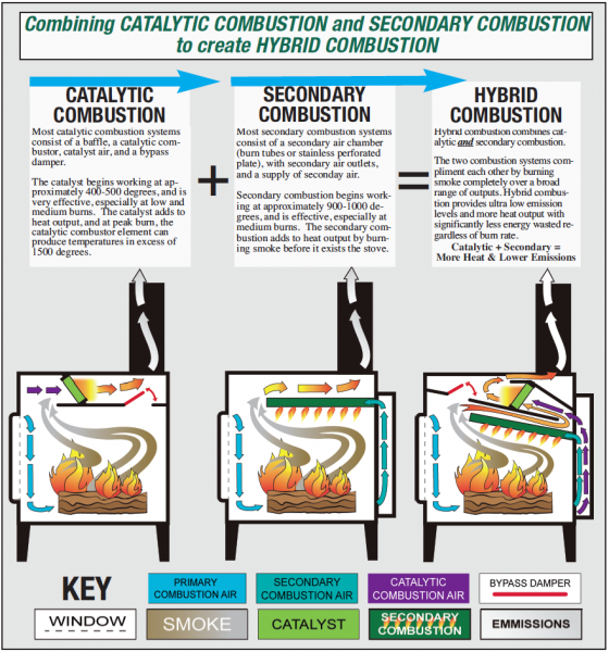

    The CAT is up above the secondary plate and the airflow is over the secondary plate and then enters the CAT chamber from the rear of the stove, so I don't know what your seeing but I can't see the glow of the CAT at all on my AS. I do think the best way is simply to watch the STT temp with one gauge and the flu temp with a second gauge.
    I usually see secondary combustion during initial start-up when I'm running wide open pre CAT engagement, and then in the early stages of CAT ignition when I'm setting draft someplace in the mid-way settings, maybe 4 to 2. When I close down the draft for steady state burn I am setting about 1 to slightly less than 1.
    But unlike the Fireview where you can just look up through the front glass to look at the CAT and see it glow, I can not see my CAT tucked up above the secondary plate. I bought a cat probe from Woodstock and it's installation took 5 minutes. It's really that simple. But since I've done that I find I just use the technique I mentioned above and don't worry about it.
    Look at the stove Picture under the HYbrid description on the far right of this picture. That's the AS stove. HYbrid Woodstove.png
