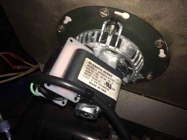

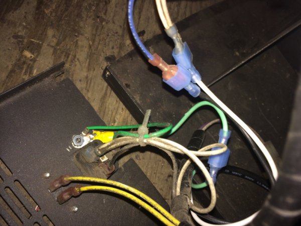

    Here is the exhaust blower I use in my Quad Contour/Santa Fe with the large blades.
    1.75 amps - More power for better Low Drafting!
    You got the 11 petal small blades, but the 11 petal large blades works even better!
    Howeve if you use either the 9 or 11 petal large blades a higher current blower is a must!
    Those 11 petal small blade motors usually have a lower current rating.
    What does it say for amps on your motor tag?
    Pic 1 - GA Blower
    Pic 2 - New Green wire goes under ground lug
    Click pic to enlarge:
    ivanhoe likes this.

    i got the gleason avery "low drafter" kit for my heatilator PS50.
    i'm absolutely lovin' it.
    i opened the feed gate all the way since the motor can now handle that.
    getting the same temps on medium i used to get on high. so i should be able to get through a hard winter like last year's pretty much on medium. pellet usage should remain the same since i'll be running on medium auger rate instead of high when it's really cold.
    it's nice to have the extra capacity, and low is so much more useful now.
