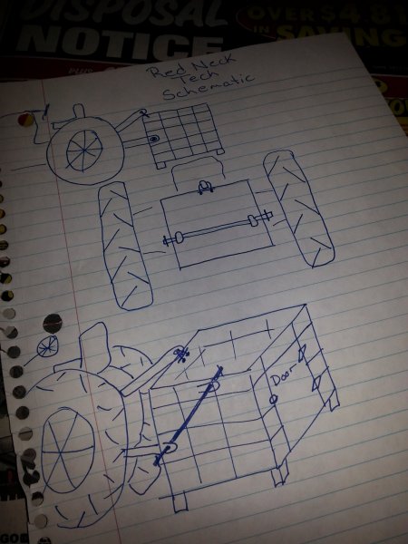

    Forgive my as my wife calls it, "my hillbilly Sanford and Son engineering compulsion". Not having it in front of me to manipulate this may need a tweak or two but...... could you find one of the 250 gal chemical shuttles and remove the plastic. Then put the bottom 2 arms through the basket. Run a steel rod through the side of the basket through the 3 point "eyes" and out the other side and pin/wire/clamp rod to basket to not slip out. On top arm get a U-bolt and secure it to top rung of basket. Then toss in rounds lift n drive to deposit location. Open hinged door on back of basket to empty and not need to reach over top of basket to get wood out. ????

    Nice drawing. Yes, I thought about buying the thingys (not sure what you call those) that the lift arms slide onto that you put the clip pin in as TSC sells them, they bolt on so easy to add. However, I thought about the forces that would be present and decided to mitigate some of that by using the cultivator frame; plus it reduces the money I have to spend. I have started on the base frame but need to get some fasteners to put it together.
