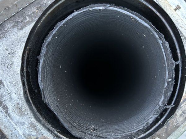

    Soon as I had sunlight I was up on the roof to see if it indeed collapsed again and it did not, seemed secure, stable, and level with the top of the cap opening. I was half hoping to find it slumped down in the chimney so I'd know what the issue was, but it wasn't so now I am at a loss, wtf is going on?

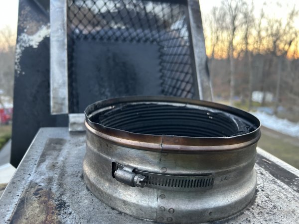

    Also, do you have a cap that has fine mesh/bird screen over it? If so the last warm/wet spell could have crapped up the screen and it needs cleaned. Scotty Overkill just posted of this issue at his house lately.

    Liner is insulated for sure and the top cap has a mesh screen over it. Here is pic I snapped this AM on the roof.
