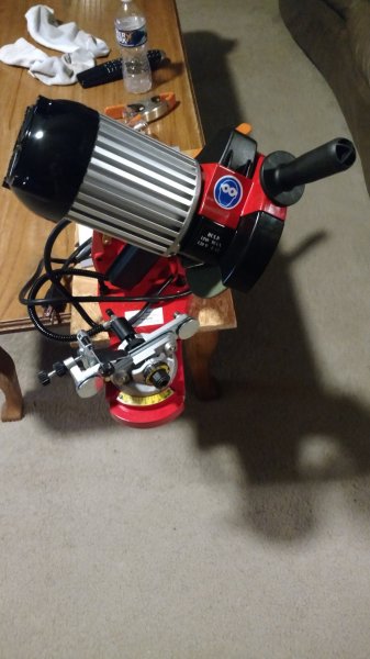

    I have a HF chain grinder that a friend gave me. After a few uses, I see why.
    I finally saved up and bought a great grinder that has more adjustments to it, with hydraulic chain clamp. IMG_20190819_231609929.jpg
