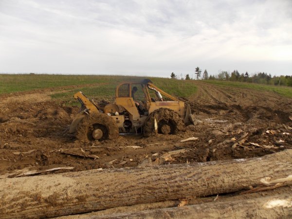

    I know all about cutting muddy wood (LOL):
