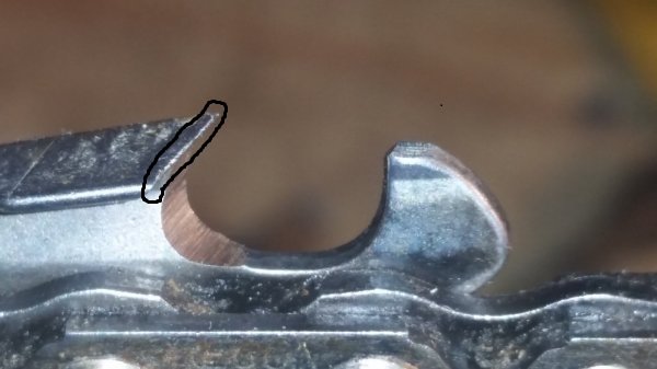

    Do you have any pics of your cutters?

  4. crzybowhntr

    Let's see if this works.
    concretegrazer and DexterDay like this.

    They are dull

    I continue to struggle with the same problem.... Is the top plate dull shawn?

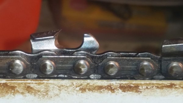

  7. crzybowhntr
    crzybowhntr
    Dec 4, 2014
    831
    2,093
    WV
    One more

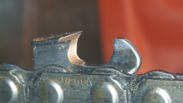

  8. SquareFile
    SquareFile
    Aug 7, 2014
    1,838
    6,567
    somewhere

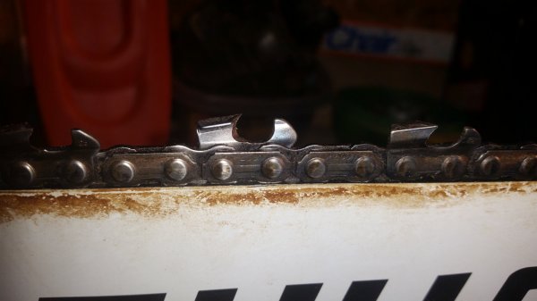

    This was probably the worst chain to show you all. I'll get better pics of a chain I think should be good to go tomorrow and go from there...

    So, I need to get that back to fresh metal.

    Yes

    Yes. Edge isn't quite sharp. One or two more strokes will fix that. The corner point was blunt also.

    And maybe the file is a tad low? Looks like a nice clean gullet, but the top plate should feel sharp like a knife.

    The hook looks like it could be a bit more aggressive to me, more of an angle. But I also agree top looks dull.

    I agree with the above. Ride the file higher, or a couple added strokes would have touched the top plate.
