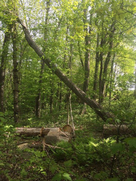

    IMG_6157.JPG IMG_6155.JPG I have about a handful of trees that are within reach that are just calling to have the final cut made, ( I apologize if I'm missing some of your detail, it was a lot to read so I skipped some), that I feel tempted to make educated guesses on. But it's not worth the risk. If your situation is dangerous now to your family or home, get a pro. Noted above, Ash is brittle and snaps where it wants to and shatters like glass when it lands.
    Safety first!
