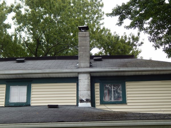

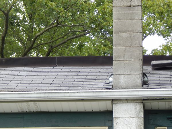

    Cupola was the best way I could describe it. Here is a picture. The height of the chimney is deceptive from a ground level angle.
    Edit to add a different angled shot. More realistic.

    It seems there’s not enough height there.
  10. Canadian border VT
    17,832
    116,351
    General rule 3 feet higher than any roof within 10 feet..
  11. brenndatomu
    22,879
    145,932
    Yes, that's the minimum.

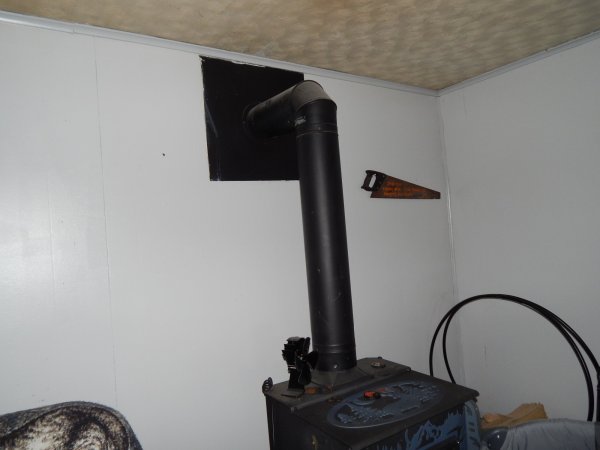

    Hey Marshal, Looks like you've got lots of good answers from others so far. I agree with all. Very difficult to wind up with too much draft without trying very hard to do it. Even so, a good airtight stove shouldn't have any problem with that.
    As others have said, looks like the chimney should definitely be higher, for clearance to the flat section of the roof and maybe to improve the draft but height is only one factor in the draft equation and I can see a number of problems in your chimney structure just from the pictures. I think you would be well served by calling in a trustworthy chimney professional. At the very least, your chimney needs some significant maintenance.
    When was the stainless liner installed?
    Couple pictures of the stove area and how it connects into the chimney may help too.

    SS linear was installed about 6 years ago and has had annual maintenance. Chimney is clay lined with 6" SS linear. DSCN0872.JPG DSCN0873.JPG
    Vertical run is 42" Horizontal 26" Chimney folks said I chimney was 22' heigh.
    Have to make an appointment with the chimney people for this years maintenance and will run adding more height by them.

    Roger, does that horizontal flue section have any rise to it? Code says 1/4" raise per foot. I like 1/2" per foot better.

    I believe it is level. Easy enough to correct. Vertical section is adjustable pipe.

    Yes, the horizontal connector pipe needs to be pitched. Would be even better if you could eliminate that 90˚ bend with two 45's and a short straight section in between.
    I'm wondering how the chimney people clean your chimney, from up top or at the stove? I see a lot of flues clogged & restricted right there at the connection because they aren't cleaned properly.
    Just a guess here... You had the flue relined after damage from a chimney fire? Just wondering when all that cracking in the block structure happened and what condition the crown is in on top. Two important maintenance issues that get neglected till they become bigger, more expensive problems.
