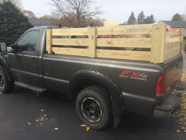

    I’ve got a 2006 f250 that has some after market 17” rims and 33x12.5/17 tires. 98648C67-667D-45B1-89B8-E3F9F287FDC5.jpeg They were all new when I bought it a couple years ago. They look cool and are good for floatation in mud, but super noisy and Not great in the snow on road since they are so wide and that type of tread. Also they are load range D which doesn’t help much when overloaded with wood. As far as fitting they never rubbed and fully turned there’s just room for me to get my hand in there. Keep in mind though my after market rims might be a touch wider and have a different offset than factory. E67A3CEA-6C1F-459A-99C4-C8400673E933.jpeg I’m due for rubber the end of the month and will be going 285/75-17 I’m thinking. A touch narrower and a tiny bit taller
