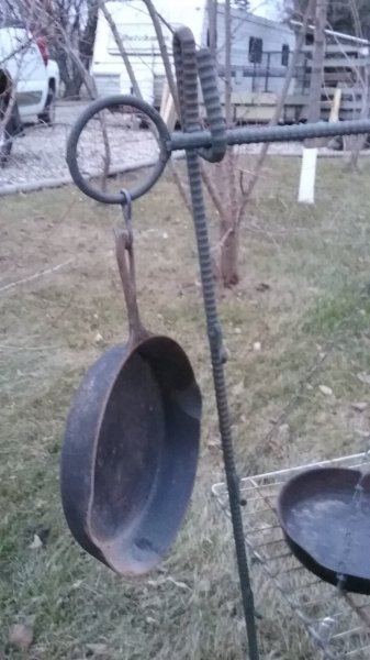

    The un purty test unit is near completion! I want to run it over a few camp fires to see just how exactly it runs. I think if I would do another, it may be a bit taller if it is going to be used on flat ground or over a fire pit. This one will work well where we camp since the fire pits are dug down 6-12 inches. Started off with 4'8" lengths of re-bar. Very surprised how well the tripod locked together and supported weight without the legs sliding out even on smooth cement. For an initial test setup, I am extremely happy so far!

    20180423_172623.jpg 20180423_172333.jpg set up in tripod formation. Weight of 3 cast iron pans and not a hint of slip!

    Set up in the goal post/cross bar style. 20180425_204301.jpg 20180425_204430.jpg 20180425_204443.jpg The last pic is the pan holder and the small meat skewer. With theseeither moved or removed, the cross bar large meat skewer can be adjusted for height onto lower hooks.
