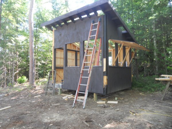

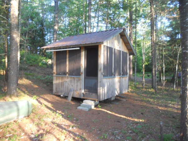

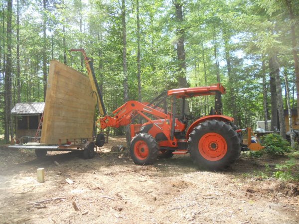

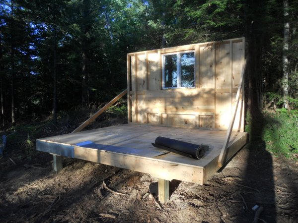

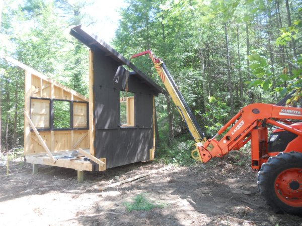

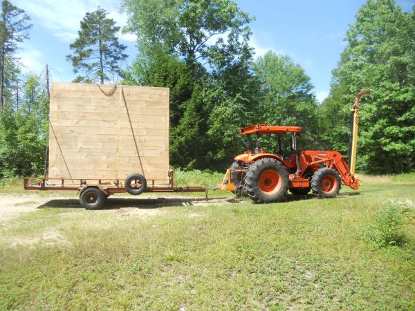

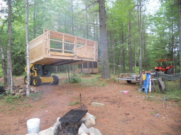

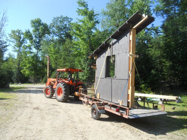

    Building another little sleeping cabin for our camp. The camp is on the property but it's 12 min ride from the house in the truck. Having no power there and not wanting to listen to a generator, I built it up at the shop (with screws) and then took the walls off the deck and trailer'ed it down to the camp in 4 trips. It even got painted first. The first one is only 8'x10' and that got built in one but the roof was seperate. I didn't want to trim the trail, we like the way it's just big enough to fit the truck through as it sneaks through the woods. The new cabin is only 12'x10', just a little bigger and easier to sneak around the bed, it's a little tight in the smaller one. This is the first cabin, those are just shutters that cover a screen, no glass. DSCN8029.JPG This is the "deck" of the new cabin DSCN8010.JPG Unloading DSCN8015.JPG in place with the back wall on it. That one window will be the only one, that is an Andersen off a replacement job and too good for the dumpster. DSCN8025.JPG These are the 2 gable ends, same process. DSCN8041.JPG set in place DSCN8047.JPG This is what the camp looks at. 0504131142a.jpg

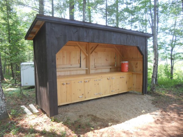

    I think I've shown this before, but we call it our "kitchen":whistle: Just a good place for all the cooking stuff and some covered counter space. This was last summers addition. DSCN7368.JPG DSCN7376.JPG DSCN7388.JPG
