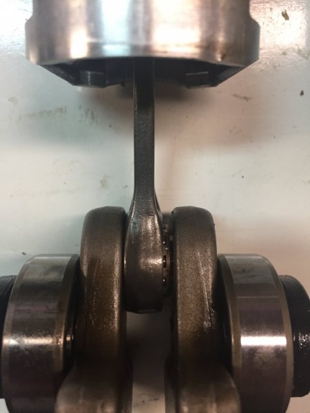

    Ok here's the deal. I got this ms250 for next to nothing. It cranks and runs but won't idle. Idle screw won't do anything. When pulling the handle, it feels like it has too much compression. So I thought it maybe will need a piston.
    Well the piston, crank, oil seals, rings all look really good. Cylinder wall has zero marks. It has a OEM carb and crank but I think the piston is aftermarket. Not sure about the head. Here's my question. The original owner said that it would crank once per day and run fine as long as you kept it running. After it shut off it wouldn't crank again. He removed the carb and cleaned it and put in a new impulse line and new oil seals and it didn't change anything. Idle screw didn't help when adjusting.

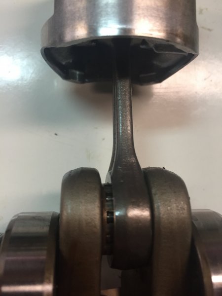

    So being it felt like it had too much compression, I was looking for a bind somewhere. The only place I found was possibly where the connecting rod connected to the crank. It has a super wide gap in it and could have a lot of play. I'll upload a pic as well showing the gap. The rod does NOT wobble but it can slide back in 4th on the bearing. What do you guys think? I may just slide a eBay carb on it and try it.

    I'd start out by re-tuning it. Run both the H and L screws down, back the L off by 3/4 turn, the H off by 1 turn for baselines. If that don't work, try cleaning and rebuilding that carb again. Use compressed air to clean it out good. Remove the hi-lo screws and all.
    Sounds to me like it was tuned wrong. I had similar problems on the MS310 I have, it was the carb that was the problem. Bought a 10 dollar Chinese carburetor off of fleabay and that fixed it.......
    As for the side thrust in your rod bearing, that is completely normal. It's actually necessary. Excessive wobble or up-down thrust isn't normal. That's an issue I'm having with my 064.

    I think Scotty has nailed it. Also like Scotty said the side ways movement is normal on the rod. Problem is the carb.
