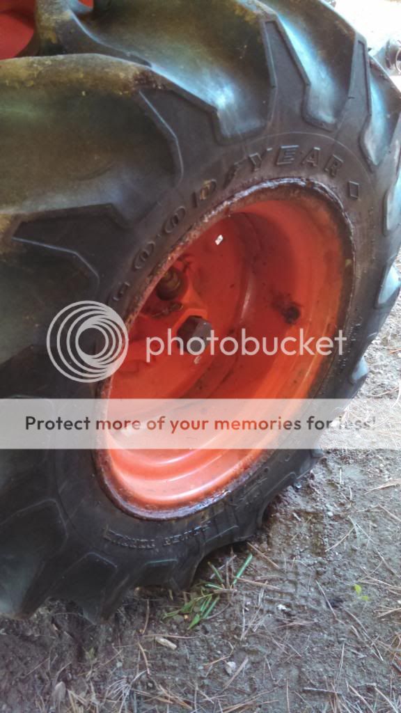

    Option A) break it down and hope to clean it up enough to tube it, add in some ballast and call it done. Cost... Probably $50-150 depending on if I can break the bead and who installs the liquid. Thoughts on gently handling this?
    Option B) new rim, hope to save the rubber, tube it, and add ballast again. This will be $120 more than option A (price of rim.)
    Option C) if the rubber can't be saved... New rims, new rubber x2... Something in the $550 range more than A.
    Option D) turfs all around, $1k plus ballast cost.
    My thinking is A, if wheel is junk then B... If tire is junk then D. I'd prefer turfs, could add a mower in the future.
    Any other opinions or thoughts on breaking this down by myself? I think I would be more careful than local shop in trying to save the wheel.

    What type of machine is it? I had the area around a valve stem get eaten up, welded a 5" x 5" plate on the inside, ground all the edges, tapped for new stem and painted it. Can you add weights rather than ballast?

    Calcium chloride is highly corrosive. I would not use this stuff myself.
    You won't know the damage on the rims until you remove the tires. I have Rimguard in my tractor tires (beet juice).

    The main thing when loading tires with CaCl, CitraStar, Rimgaurd or similar is to make sure the rim is completely submerged. If it is not, the alternating exposure to the ballast and then to oxygen is what corrodes the rims. No leaks and the proper fluid level in the tire, and the rim will last a good long time regardless of what solution is used for ballast.

    It's a Kubota B2100 and I bought it used about 3 or so years ago. I knew it had liquid ballast after checking the air pressure one day. I noticed the corrosion probably 2 years ago, and I should have responded much sooner.
    I know CaCl is highly corrosive and if I will probably go the WW fluid route next to round. I did find a dealer with Rimguard and that has a decent amount more weight per gallon so I will price that option.
    I figure a good welder might save it... But only one way to find out. She wears a box blade when doing loader work, but being so light in the pants I would think a couple hundred pounds of ballast helps a lot.... Or I could start eating more.
    Ack... Good stuff as usual MM. Now about breaking that bead.... Log splitter the way to go?

    I'd go in expecting to need a new rim. Maybe you'll be lucky and it'll clean up and have some good steel still. You'll probably have to tube it but I won't run fluid without a tube anyway.

    Funny to see this thread today. Last week my neighbor who has a Case Sneaker trencher needed a tire repaired. It had calcium in a tube and the rim had a 3"x3" hole where the stem came out. I drained the calcium,welded a patch over the hole,drilled a new hole for the stem and filled the new tube with washer fluid. :)
