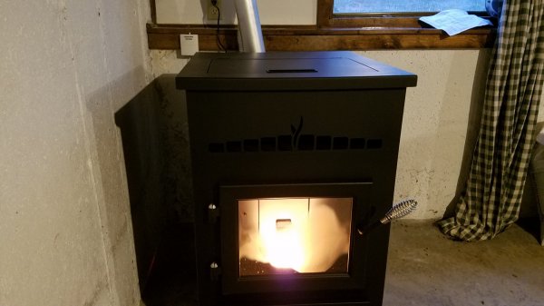

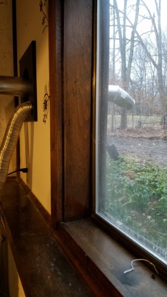

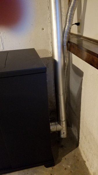

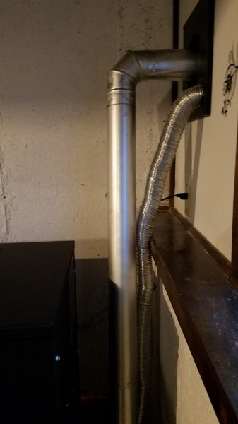

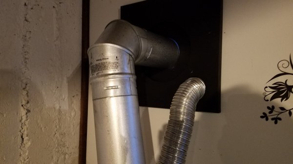

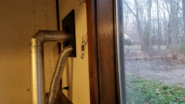

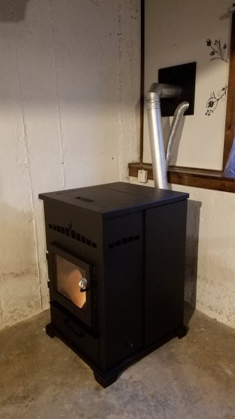

    We're hoping to heat above the basement. We just noticed when running the unit it is not even heating our un-insulated basement and we thought that was odd. 20190105_160431.jpg 20190105_160437.jpg 20190105_160449.jpg 20190105_160456.jpg

    That's not a very big fire, have you tried turning it up?

    Install looks good.Flame looks low,if you have it switched to high.You may have to open up the fuel rod adjuster.Bare concrete walls will suck the heat fast.

    That thermostat is way too close to the stove, especially for a basement install. Move it away as far as you can... and setting it at 70 just won't cut it to warm up the entire basement.

    If wanna even stand a chance of heating that size of a basement your gonna have to crank that puppy up and it's gonna eat some serious pellets and once it does start to warm don't let it cool back down.

    As for your install, as has been mentioned above, basement installs in un-finished basements are usually doomed to failure. Not saying impossible, but VERY difficult. The stove, even cranked-up, spends most of it's time trying to warm the concrete walls & floor.....not much makes it much farther.
    You would have been much better served to install it where you wanted the heat (living area?) Did the stove company do the install? Did they even mention to you about the location? Was the location YOUR idea of theirs?

    If that picture is the stove on high, you need more fuel.
    What kind of pellets are you using?
    My cab 50 is in my basement and does a great job at heating the whole house. But basement is finished.
