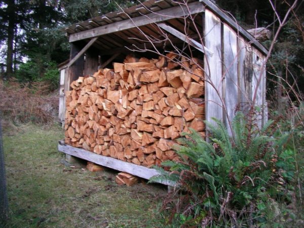

    Seasoned multiple years? Split or unsplit?
    In this part of the world, we have several species that will just rot if the rounds are not split, and in most cases have to stacked in a well ventilated area, under cover from wind driven rain if you want the the splits to dry.
