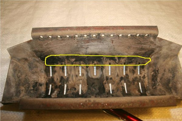

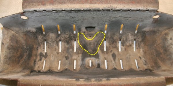

    That's probably what you'll see is its pellet related. I find that Stove Chow effects my stove with carbon build up more than the MWP or AWF that I have been burning.
    I drilled some extra holes in the burn liner to reduce the build up by the igniter area as it was the most effected zone. And where the build up seemed to interfere with the agitator the most.
    Then I drilled a few holes alone the back where I noticed more build up.
    I'll post pic's of the burn liner next time I have it out. But after drilling some extra holes I can easily go 2 weeks(or more) before I hear the beached whale grown noises. In the second picture you can see how the carbon built up around the stock middle slot under the circled area. But in front where there is no air slot or holes the carbon build up is far worse.
    Your liner is different than mine, So it may require drilling holes in different locations than where I needed to drill.

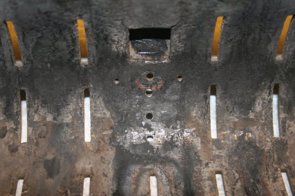

    This pic was after I drilled a test hole to see if more air would help. Notice there is no carbon where I drilled the hole.
    You get the picture, keep drilling holes(approx 3/32" dia) where the carbon sticks. It should help where the worst build up is. ;)

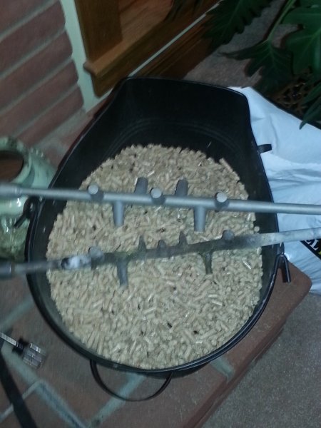

    Hey guys little idea here,my dad used to burn a mix of corn and pellets and would get build up like you guys are getting. I'm not sure where he got them but he got some oyster shells and sprinkled it in when he filled the stove and it seemed to help. I'd be interested to hear back if anyone had tried this or had anything else that works? I also made him a couple steel agitators used for mixing the pot,made one out of stainless as well because they were wearing thin!

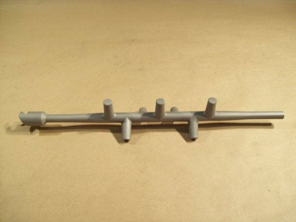

    Can you make one for an Enviro M55...If so how much??

    Yea most likely got a picture and a couple measurements?
    wildwest and ivanhoe like this.
  17. eatonpcat
    9,807
    55,039
    Best picture I have...The left side in the picture has a fancy cut as it turns into place.

    Yes i can make that it looks like it is tapered on the ends? Is it a clearance issue? I might have to have you cut the end of the old one and send it up so i can weld it on or re fabricate it. Looks like you have a spare at least
