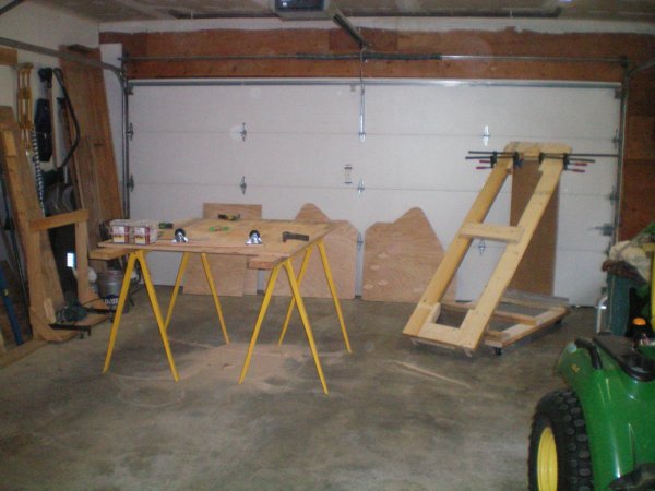

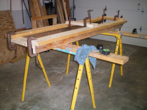

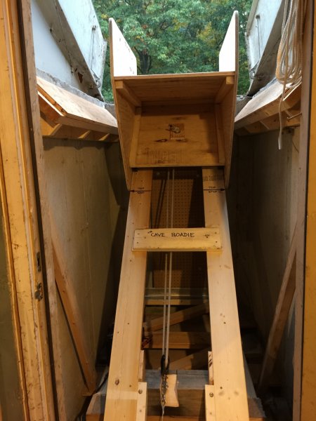

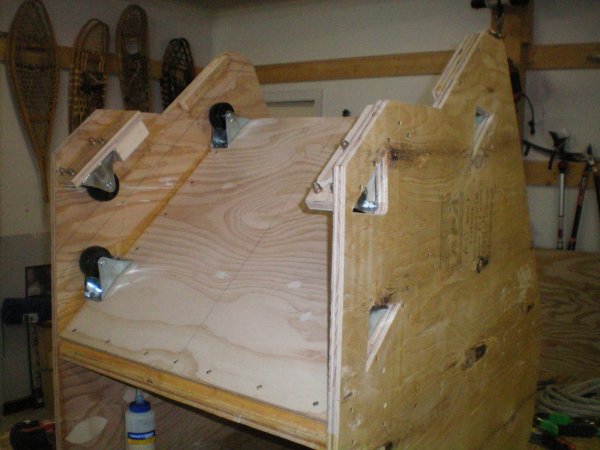

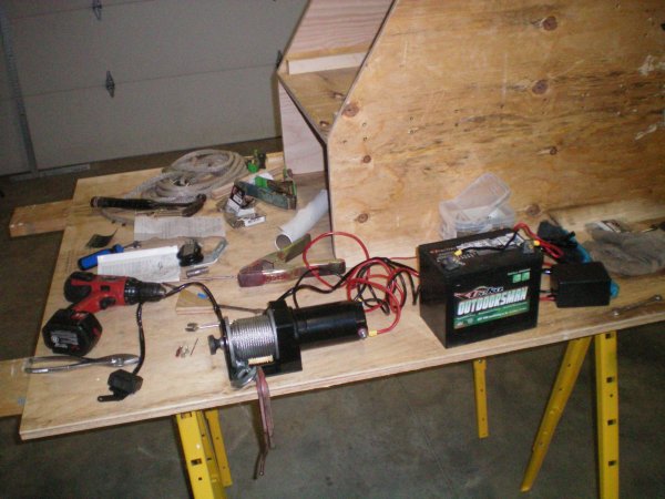

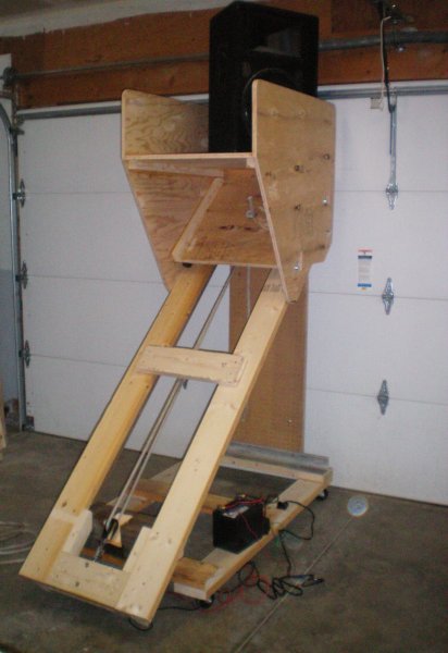

    Finally got the lift finished in the shop and re-assembled in the basement today. Used old lumber, pulleys, rope, casters (hope they hold up OK) and a 10 year old (new) 2000 lb winch... had to buy a sheet of 3/4" plywood and a small tractor battery. Lifts 100 lbs without any trouble (could probably lift 200, but I'll use 100 lbs as a max). The carrier deck "lands" at about ground level up top. Rigged the 2-1 block and tackle to speed up the travel time... it's about 10 seconds, which is good. The main carrier rail set-up is glued and screwed together. The entire rig is on casters and rolls in on the same "tracks" that I made for my 2 firewood bins. I'll roll it into place when I need the lift but will store it inside. Have 4 players coming on Thursday and it's gonna get used a lot. Looking forward to it.
    As per the rules here at FHC... the mandatory proof photos... ;)

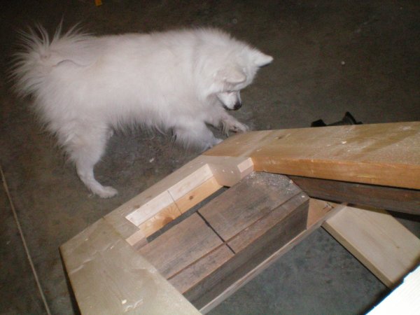

    Inspector Giz giving it a once-over before first lift tests...
    60 lbs...
    In position in the Bilco area... the ole Cave Roadie... ;)
