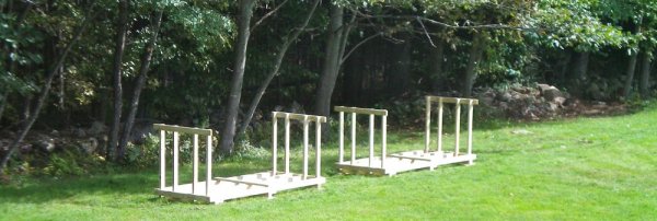

    Trying stack cribs for the 3rd yr wood. It's about time. I like BogyDave's double row idea for stability, so I thought I'd try a couple of 4'x4'x10'. Each will hold about a cord of 20" splits. Here's proof I actually got off my azz...
    All leveled up. No more excuses... time to stack... anytime.

    After seeing others keep the areas clear all around their stacks for mowing and loading wood, I decided to move these out away from the stonewall too. I think loading the wood will be more gooder, being able to do it from both sides, and it'll be in the sun a bit more.

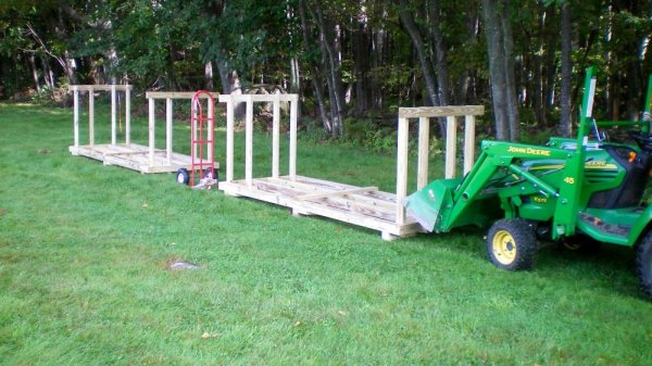

    Thx Fan. I used 12" pieces of 2x6 PT as pads. They're lighter and easier to work with than concrete pads and, once I had the cribs level, I just drove some 4" screws down thru the pads to capture them if they want to move... which I doubt they will with wood stacked.
    Gonna stack high in the center, maybe 5', and pull that clear greenhouse tarp stuff I used on the shed, hard toward each end, and screw a narrow strip just under those 2x4s at the top of the ends. That clear stuff is incredibly tough so it'll be interesting to see if it'll stand 3 years of weather abuse, and maybe get a little advantage from the sun with drying too. I've never had much luck with the green/blue tarps. The sun just kills them.

    I was hoping to slide some fork tines I've got under the cribs and carry each one but... I'll bet they weighed 400 lbs. The bucket will lift about 350, but not on the forks. PT was soaking wet and very heavy. Oh well. I'm sure all those pieces will look like cork screws in a few days, the way PT takes off twisting on ya.
    I've never had a project I've gotten into yet, where that lil ole JD couldn't get it done somehow. I like how I can get it tight places with it, and pull it on just a 5x12 utility trailer. I'm lucky here too, if I ran into a job that really needed more muscle, my next door neighbor has a larger Kabota. Besides, if I had a larger tractor, I wouldn't be able to afford running it with all of the damage I'd do with more hydraulics at my finger tips... gawd... :D
