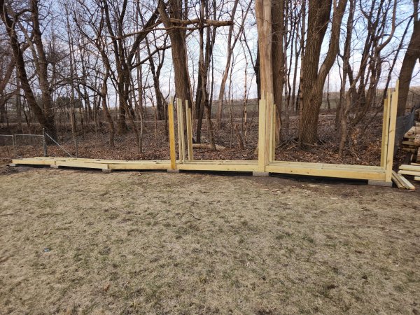

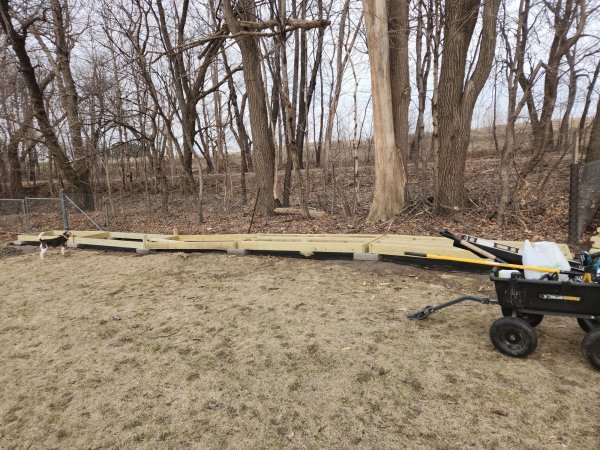

    Got started on this yesterday. Not really a shed and most certainly not as nice as many I have seen on here by some of you guys. But hopefully it will suffice for what I need. Going to be a long process as I can't devote full attention to it.
    Seeing how this past winter was my first one burning and I pretty much only did it on the weekends, didn't have much more dry wood to do more than that. I am not sure how much we will go through but I am guessing about (1) cord per season. This should be large enough for what we should need...but only time will tell.
    I figure it will hold about (5) cords. It is (5) sections long, 8' long per section. The plan is to have it two 16" - 18" rows deep with about 2" - 4" between rows. It will be about 6' tall at the front of the right side and have a 3" drop to the roof. I didn't want to have to do a bunch of foundation work to have the base level so I will level the roof side to side which means it will be taller on the left side. Not sure what the distance is yet but my guess is about a foot.

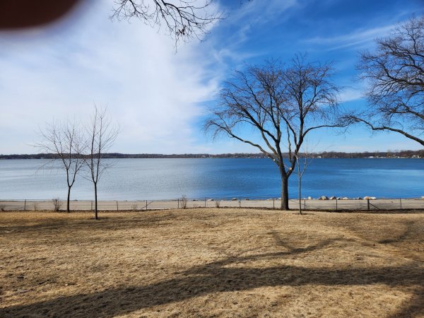

    This is about 200' from the house and backs up to DNR land behind it. It was the best location for access and getting wind for drying. It is also flat from there to the house so don't have to worry about pulling up hill when bringing wood up. The one pic shows the direction the wood faces. It is West-Northwest which is where we get about 90% of our wind. It comes all the way across the lake with nothing to stop it, so this will get some really good wind for drying.
    Got started yesterday with the foundation blocks and the bases. I'll post more pics as the progress continues...and eventually gets full up with wood.

    That giant dead tree on the other side of the fence doesn’t look like it is leaning in a favorable direction. Any chance of taking that down before you continue?

    I knew someone was going to bring that up. lol
    I wish I could but that is on DNR land. And one thing you do not do is cut anything on MN DNR land.

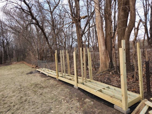

    Didn't think I was going to be able to work on it at all today. But I was able to get a few hours in.
    Got the rest of the joists in. Got all the hangers on and all the blocks in. And even was able to start going vertical.
