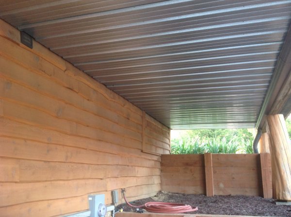

    Not sure if this will help but it keeps the mud room entrance dry as popcorn.
    Water filters through deck.
    Corrugated metal slopes down to gutter then out.
    I have no need for walls but you certainly could incorporate them.

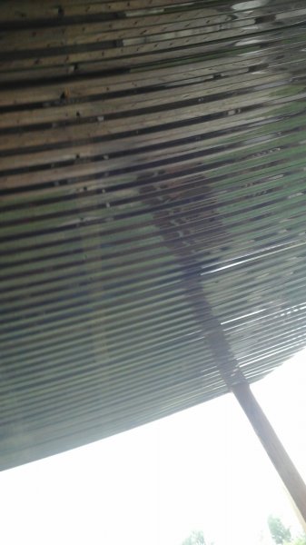

    yeah I did a covered deck over deck with polycarbonate skylights so Deacon would work. I have PT deck boards quarter inch gap 2.5 inch drop in 12 feet. it's dry. I you want to insulate and heat. it can be done with rubber roofing but make sure of all seams! 20150711_165331.jpg
