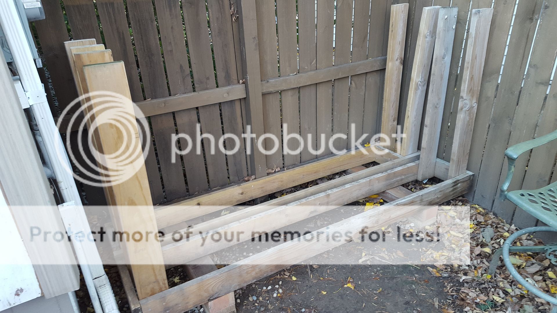

    I started out with a level platform for them to sit on made from some scrap treated wood.
    Then I stacked the racks two deep on the platform.

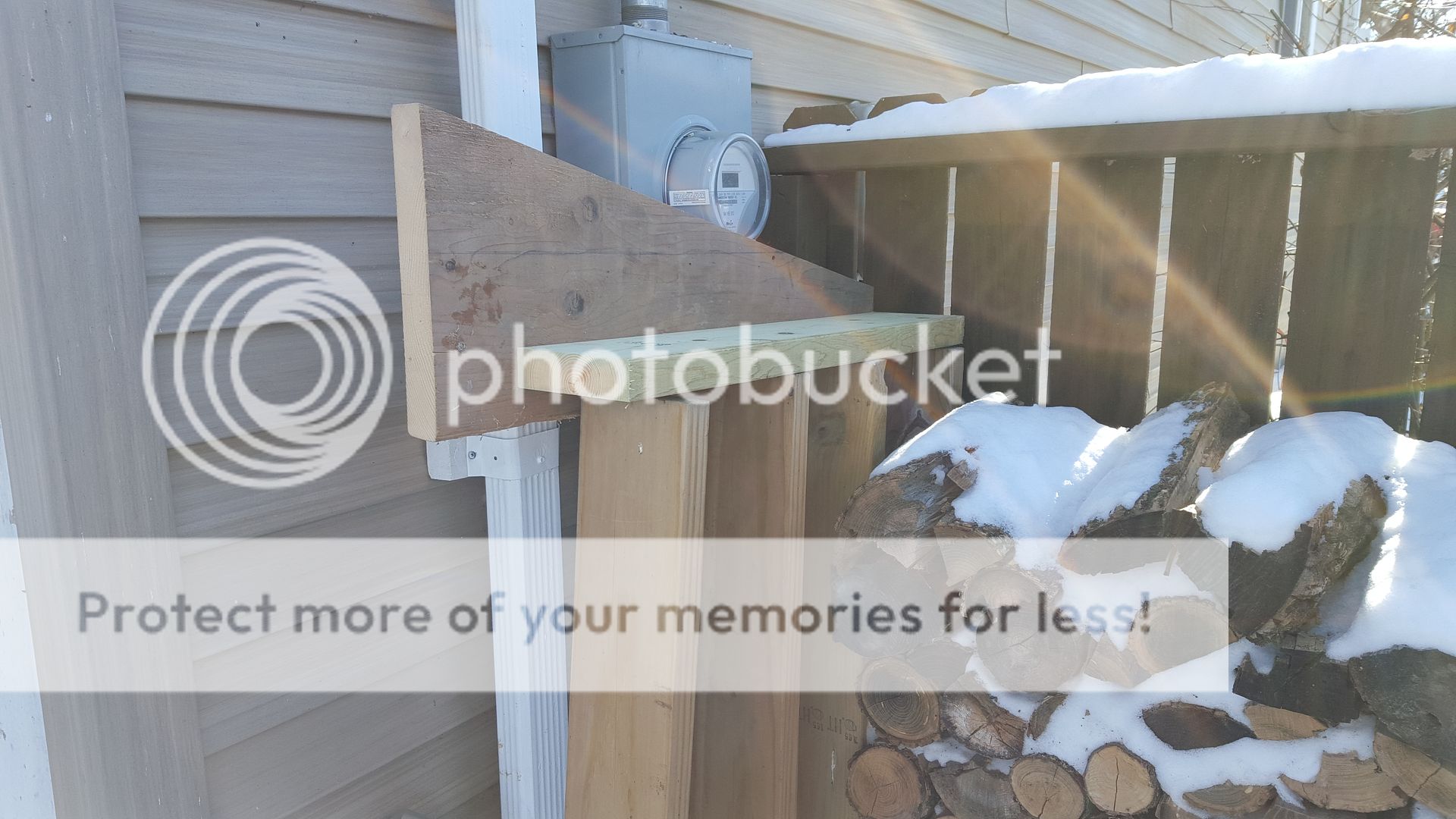

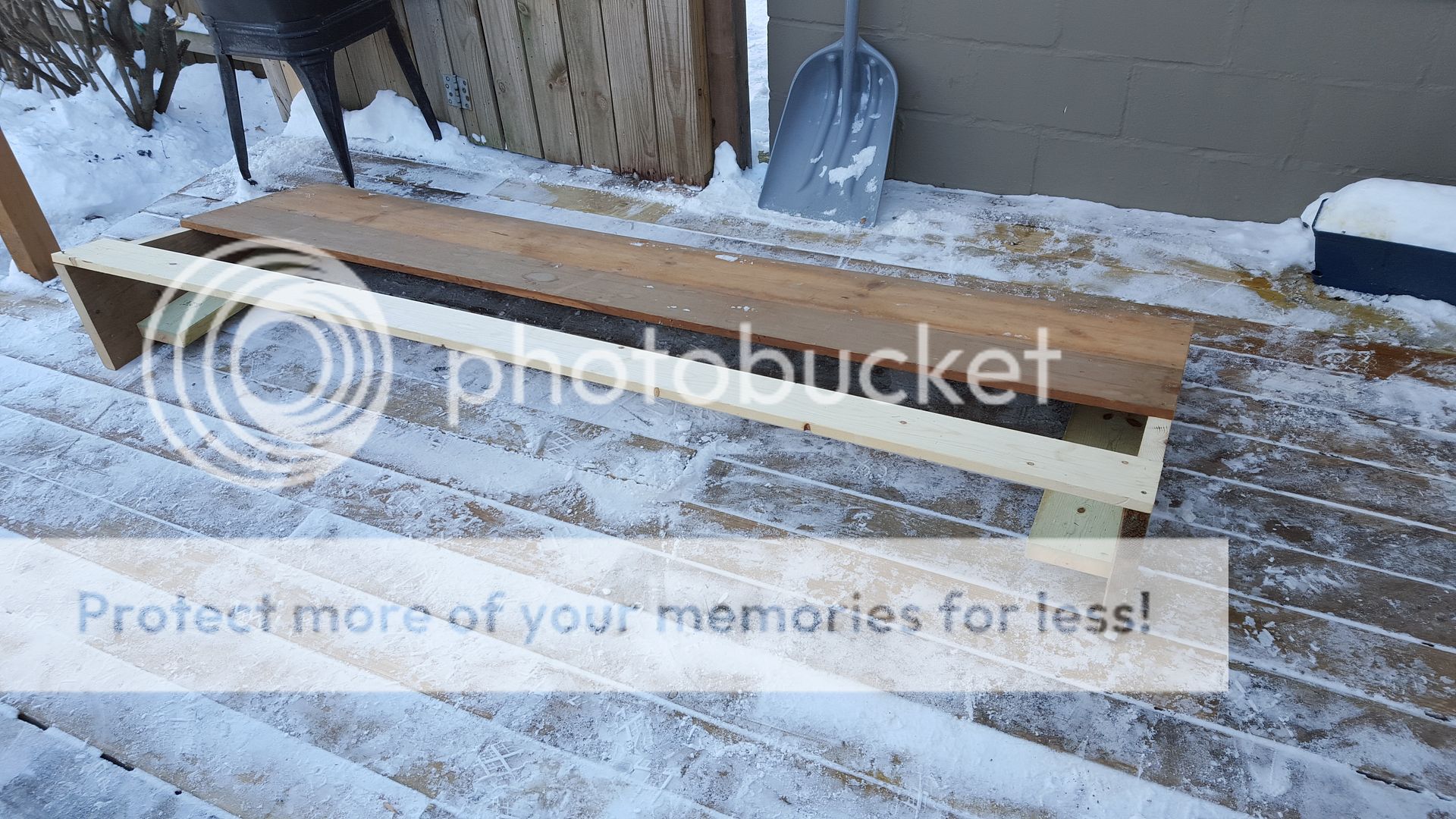

    I used a scrap 2x12 cut on a slope and a piece of treated 2x6 to build the ends. The 2x6 is screwed to the angled 2x12 but not to the rack. You can see even with a level platform to sit on, the rack has warped over the time.
    I then used a couple scrap pieces of 1 by material to start the roof build. You can see I used a new 1x6 to square up the roof and still have to buy a 1x8 to finish it out.
    Here is the test fit before finishing it with the other 1x8. I also need to put a support for the roof to keep it from bowing under snow load. It will be a 1x4 purlin in the center and 2x4 beam running left to right. You can also see how I didn't get wood stacked in the other rack yet and this project done in time to keep the snow off the wood.

    If you use some lead flashing on that left side maybe they wont be able to read that electic meter too.

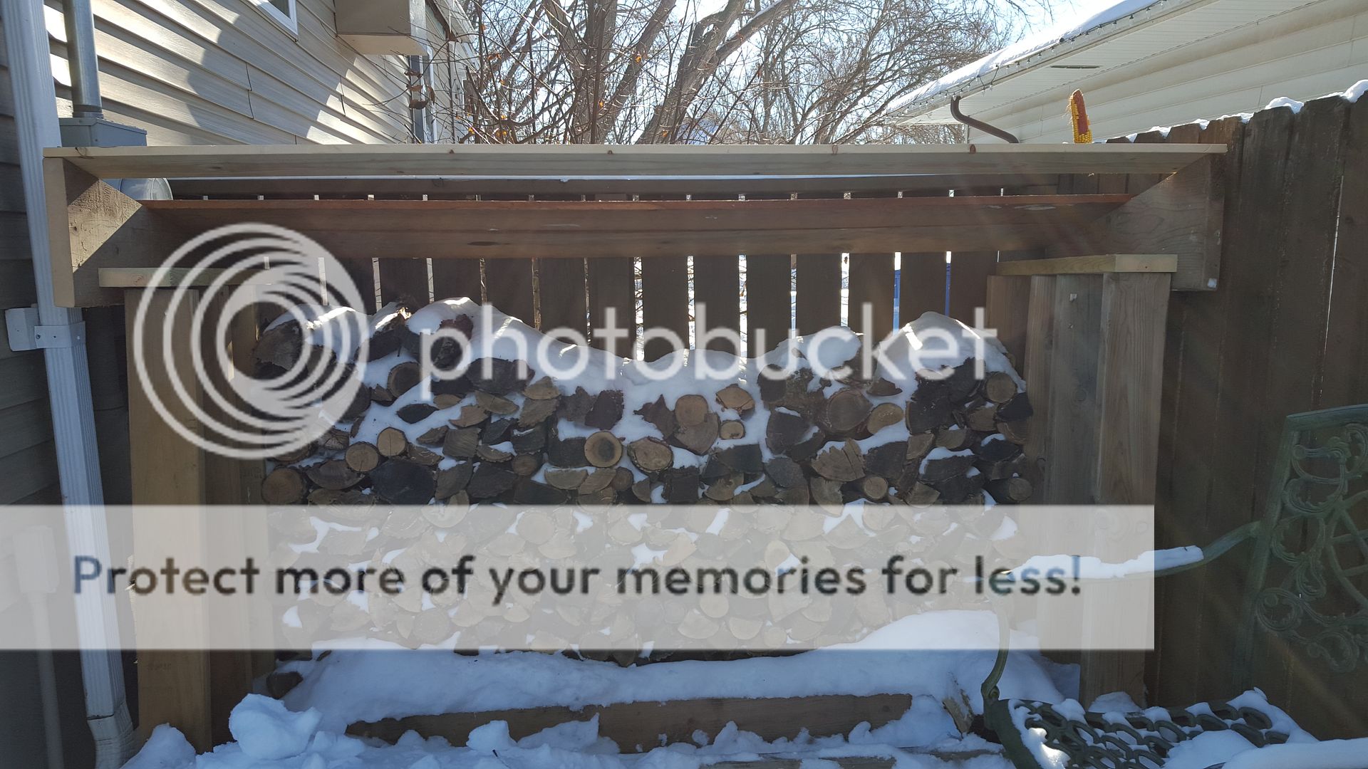

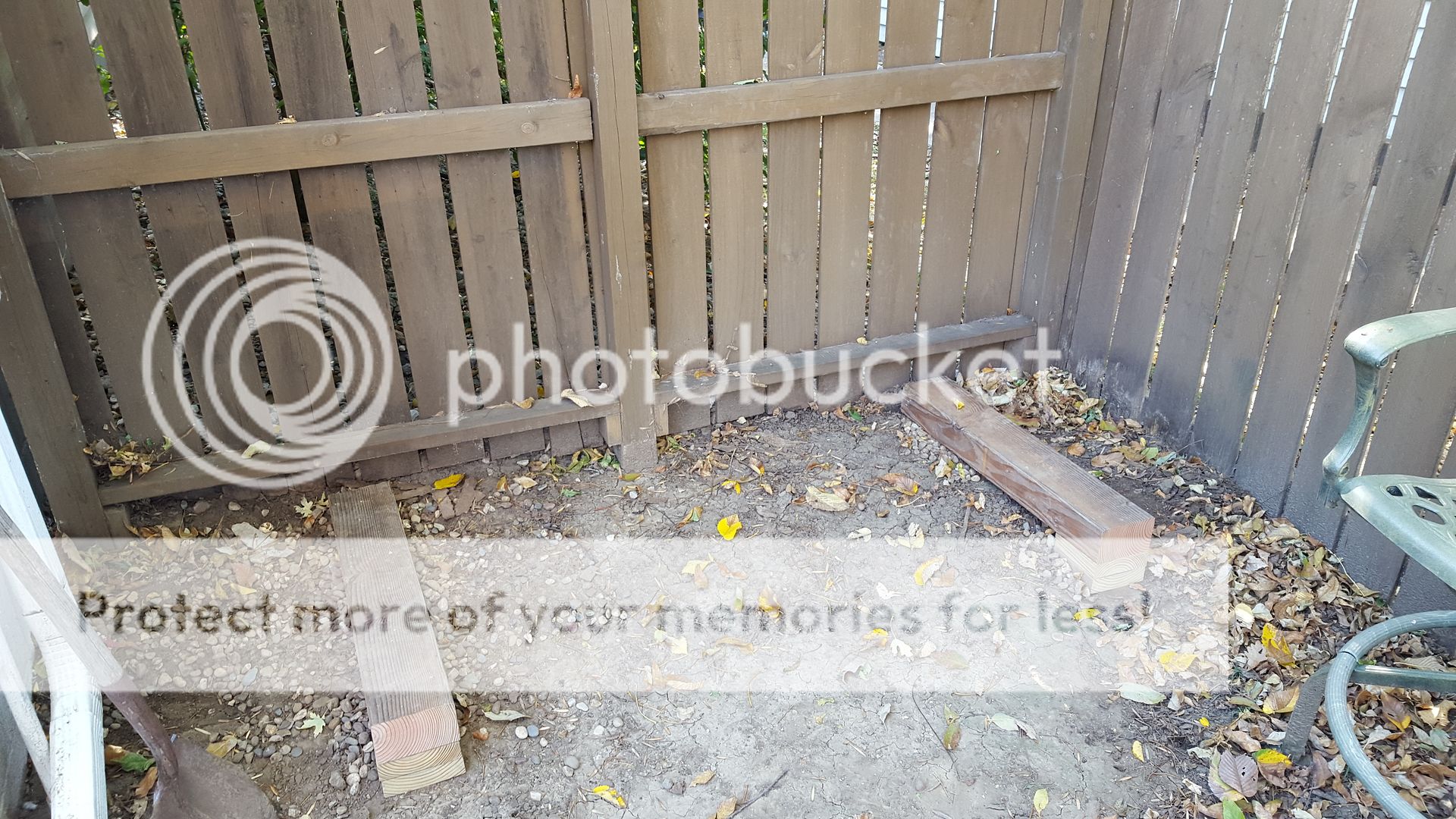

    Had a little time yesterday and this morning, so I worked on this project.
    Yesterday I moved the racks so they wouldn't be so close to the house and so they faced away from the north winds.
    Dug in some concrete block for support on one end and blocked up from the retaining wall on the other.
    This morning I finished bracing the roof and blocked in between the rack ends. It's still not the straightest looking since the racks have warped some over the years but it better than having wet wood during burn season.:)

    If you put a tarp or something on the front in the winter it will keep the snow from blowing in on it.
    That's not a problem as long as it stays cold, you just knock it off, but if it gets above freezing it will melt down in your wood and it will be soaked , not good if you want to burn it right now.
    I have a couple of small racks similar to that with roofs, on the back deck and that's what I Do, cover front and back with tarps

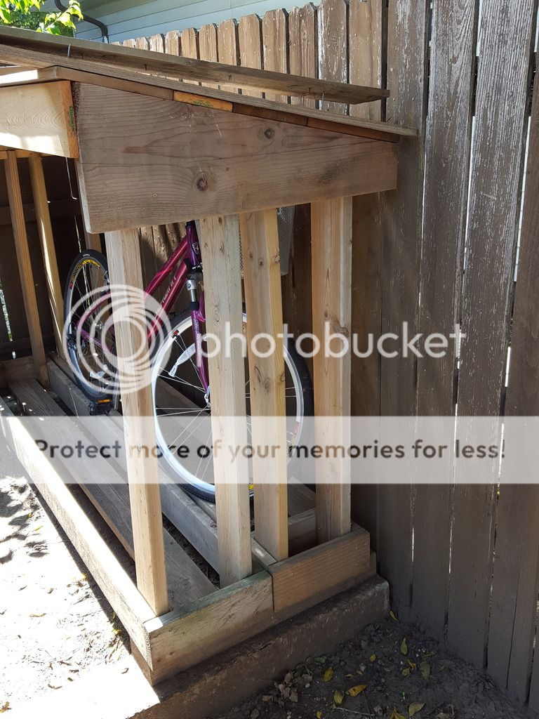

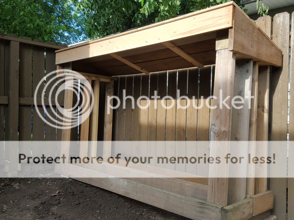

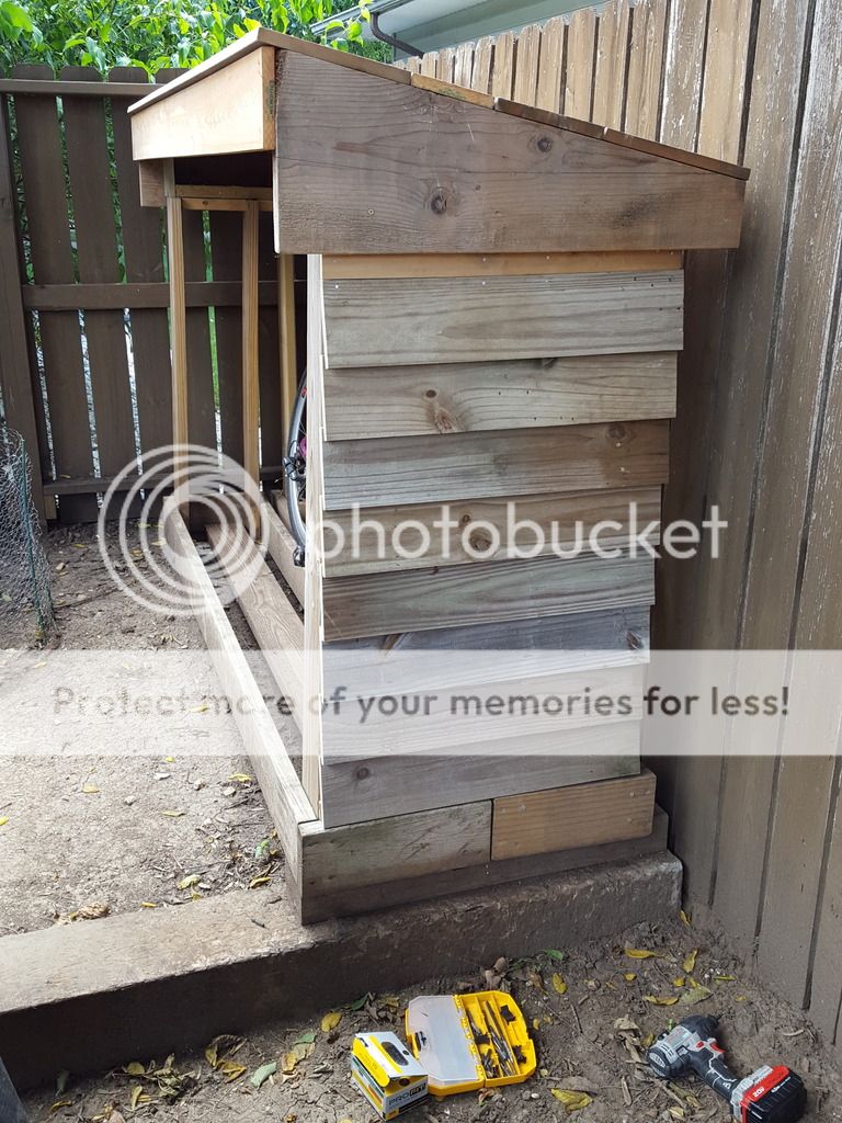

    We took advantage of the roof to store my brides bike for the summer, but with fall approaching, wood will soon replace it.
    I decided to use some salvaged wood from a fence project to improve, what's become a semi-permanent wood shed.
    Im just doing the north side to keep the wind from blowing into the racks. Almost done but I'm pretty excited to get it filled up. :)
