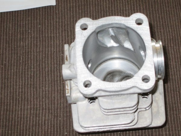

    Well guys I finished up my second PP365. List of things done on this saw.
    Opened up the ports. Intake and exhaust.
    Ground on the top of the transfer ports to direct them a little more towards the intake.
    Opened the bottom of the transfer ports a little.
    Thinned the bottom of the divider between the transfer ports to get better flow.
    Dropped the cylinder to a squish of .022"
    Port matched the intake rubber boot to the cylinder.
    Port matched the muffler to the exhaust port of the cylinder.
    Installed new crank seals.
    Advanced the timing.
    Installed a new OEM piston and ring.
    The cylinder was a used one I have had hanging around for the last 3 years or so.
    I used a ball hone on it to soften all the edges of the ports. Less chance of hanging a ring. Then ultrasonic for getting it really clean.
    Changed the carb over from a HDA 49 to the HDA 164. Bigger carb.
    Installed a new rubber intake boot for the larger carb.
    Put on a used metal plate and gasket that goes between the carb and rubber intake boot. Required for the bigger carb. I got it from a 330 parts saw.
    Modified the muffler.
    Tuned the saw to 4 stroke at 13,000 RPM's with the bar and chain on.
    This is not a race saw but a good running working saw that I will use in the mountains come summer time.
    One more thing about the PP365 is that it weighs less than the 3750 but with these modifications it now has the same output power.
    Ran the saw today and it will flat get with the program. I really like this series of saws from Poulan and with the right modification can really be made to run.
    First a few pics of the cylinder while I had it off and all the work was completed on it.
    Then a few more pics of the muffler mod.
    The pic with the flat piece of metal laying next to it is what I used to do my muffler mod.

    Thanks for the compliment.
    I got the 365 for free with a scored piston and cylinder. So I am just in it for parts.
    Really all I wanted to do by posting this on here is to show that you do not need a very expensive saw to have some fun with our hobby and produce a good running saw
    that will get the jobs done. The PP 365 is a 60cc saw open port transfer design and with a 20" bar will handle most job easily. You could do this very same thing on any number of saws that come from Jonsered, Husky, or Stihl and even some of the older Homelites. I am sure there are others also. Have some fun guys.

    The grinder is a dremel.
    The ultrasonic cleaner is a harbor freight.
    The bottom of the cylinder was done with sandpaper.
    Then there is the ball hone with a cordless drill.
    The burrs I used came from ebay and were very cheap.
    I did not use a degree wheel for anything.
    I used a penny cut down for advancing the timing.
    Nothing expensive there for tools.
    You do not have to have expensive tools when it just takes a little know how to have some fun.
    That is what I was pointing out.
    I am not a pro builder like you see for all those Mastermind saws you have listed there.
    The only expensive item I used was the welder for doing the muffler mod. But I have done them by just cutting a slit in the side of the muffler and the prying it open. Works just as well.

    For what you paid to have one of those saws modified by the pro builders you have listed would have more than paid for all the tools I used to work on this 365.

    Actually I think your professionally built saws are better. Those guys have lathes to cut the squish band and degree wheels so they know exactly what the port timing is and they do not sand the cylinder base they cut it on a lathe to precise measurements. They have angle head hand pieces for their flex shafts so they can get into those tight areas for precise work.
    Shawn you could learn all that your self it just takes some time is all. Not rocket science.
