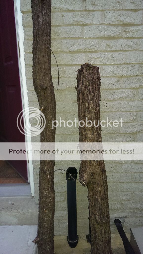

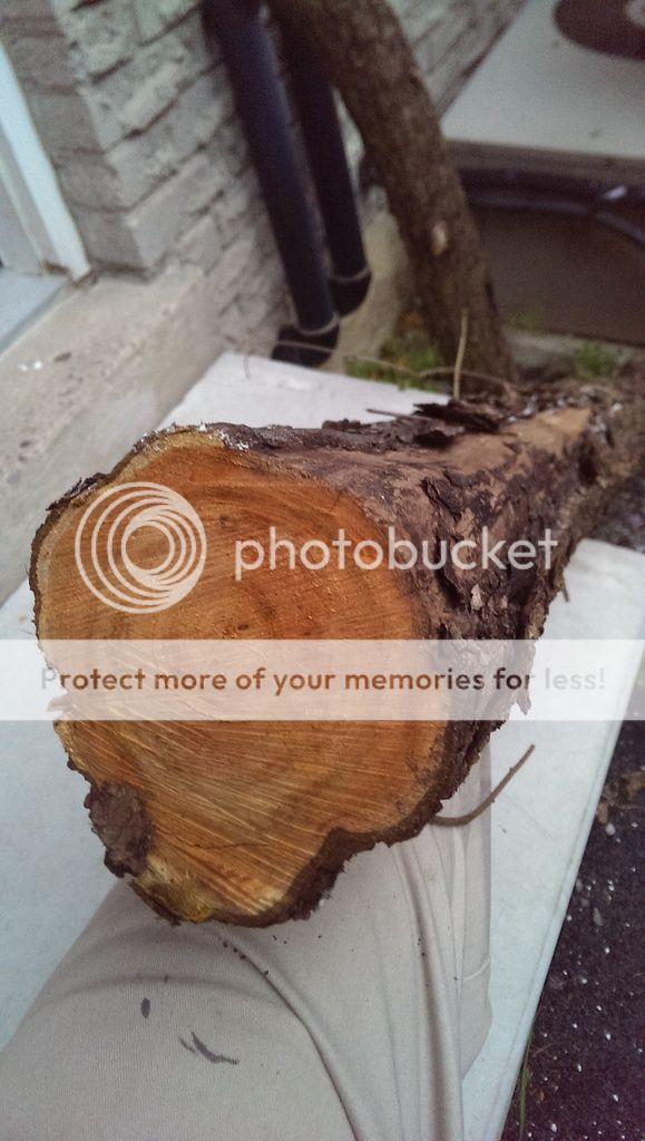

    I'm doing a bit of woodlot maintenance for a client; cleaning up some deadfall poplar. The homeowner also wants some of the Buckthorn removed as it is an invasive species. I'll say it is; if all the Poplar fell and the Buckthorn were removed, the woodlot would become a vacant lot. I don't have a mill or a bandsaw, but these two logs are only about 4" & 6" thick so I'm going to try milling them on my table saw.
    Anyhoo, here is a pick of some I culled. Check out the beautiful red/orange grain:

    That looks just like some American Smoketree I found on the curb about 3 blocks north back in late 90's.Quite dense & pretty stuff,its hard to dry without major cracking unfortunately though.
    Compared the leaves on those pieces to what was on a small volunteer shrub in my backyard - turns out I also have one here.Its about 20 feet tall now,5 inches diameter with lots of small dark purple berries (think elderberries but larger & single stemmed instead of in clusters). I don't remember what the flowers look like,but those berries are usually plentiful in July-August,can be messy.

    I might take a hint from your post and paint the ends so it doesn't check so easy.
    You might want to get rid of it if it is indeed Buckthorn (and it sounds like it is) It can take over a lot in a few years and is thick & thorny. Here is a link to ID and it's behaviour: Common Buckthorn | Ontario’s Invading Species Awareness Program
