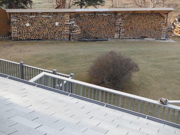

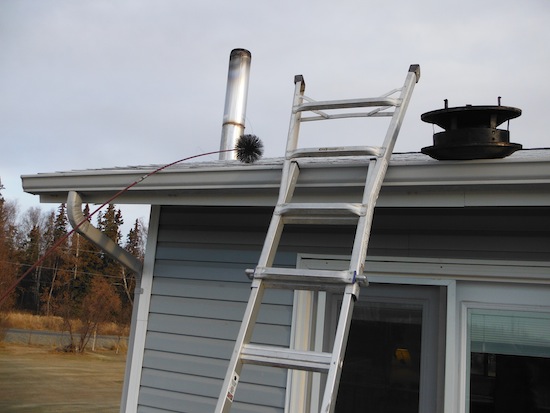

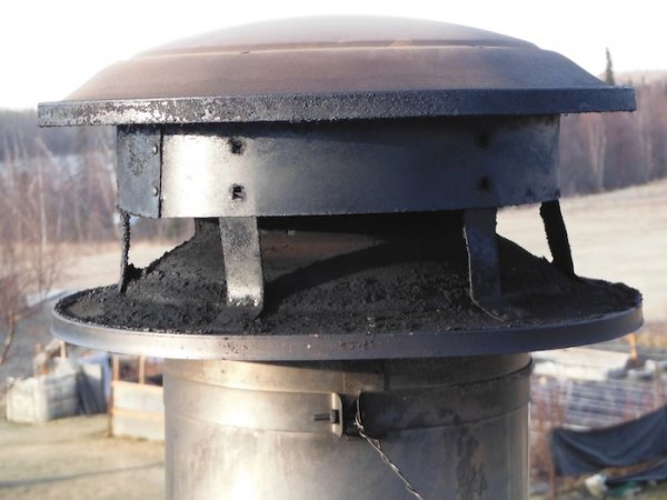

    Went up on the roof, pulled the cap.
    Slipped while holding the cap, then I notice all the frost on the roof. o_O
    What was I thinking ? That's the problem, I wasn't thinking ! Dumb-A$$ !!
    Inched my way down on my butt , carefully got on the ladder,
    Will wait for the sun to hit the roof, hopefully melt off the frost.
    Scary moment adrenaline rush for sure. Whew !
    Better to be Lucky than good :)

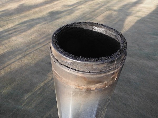

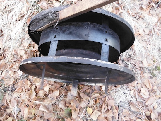

    I did get the cap cleaned & ready to go back on.

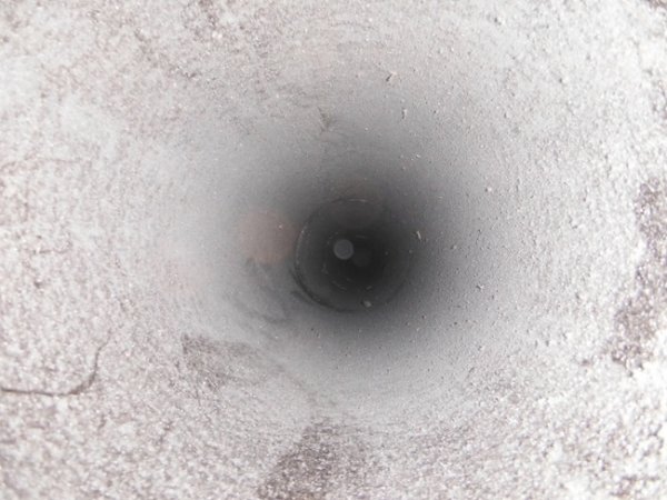

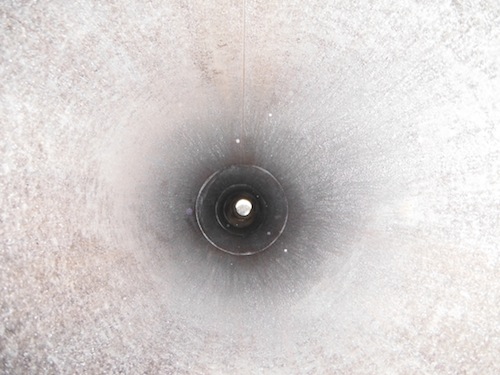

    I did take some pic though.

  6. bogydave
    Frost free roof (South side anyway) :)
    Didn't take long
    Wasn't worth the effort but was worth "peace of mind"

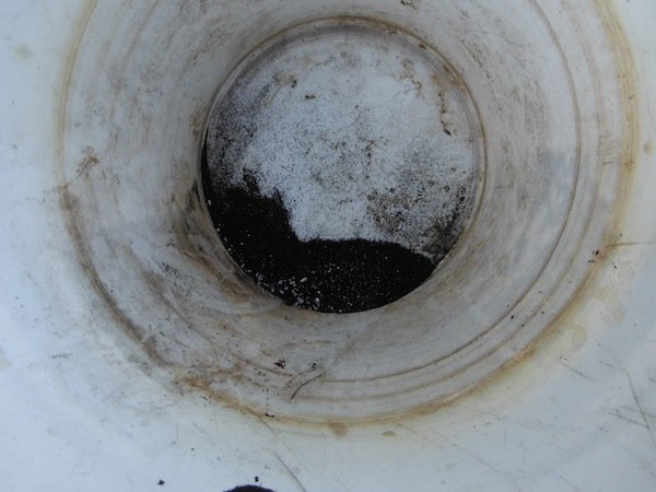

    Some dust in the bottom of the bucket :

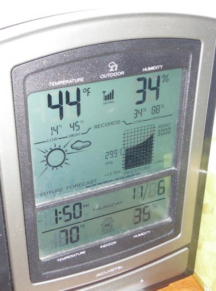

    Sunny side of the house temp
