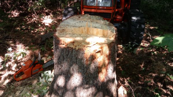

    So I get there and you can see the tree is sitting back 5 to 10 degree so I told him a wider face cut would have solved problem and I have to teach him bore cut..Base is about 28 inches.. Pics aren't great cause to dark in woods at 2pm but here they are..
    The stump

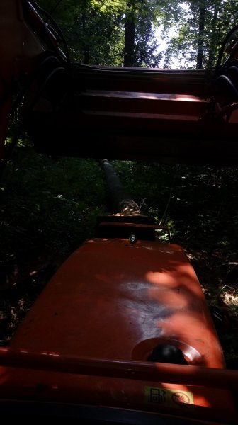

    Bucket pushing it over as wedges would not move this tree a little nerve-wracking because dead Pine branches 50 ft in the air are not healthy for anything

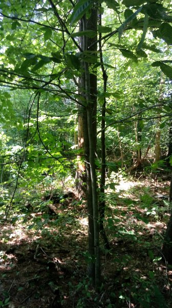

    Here you can see the face cut being too narrow and there is a 460 Rancher with a 20 inch bar stock to the right but you might not be able to see it

    Brother has a learning disability dyslexic. .. so I was focusing on the whole learning the lean of the tree.. I pushed it over with Kubota FEL it was 80 percent cut but i wanted a clean push and NOT rock it so it would fall in intended direction and dead pine branches wouldnt rain down..
    a bigger 28 to 30 dbh tree is different technique 12 to 16 .. when bar will not make a single back cut...and I wanted him to learn
