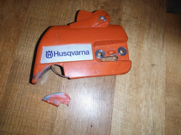

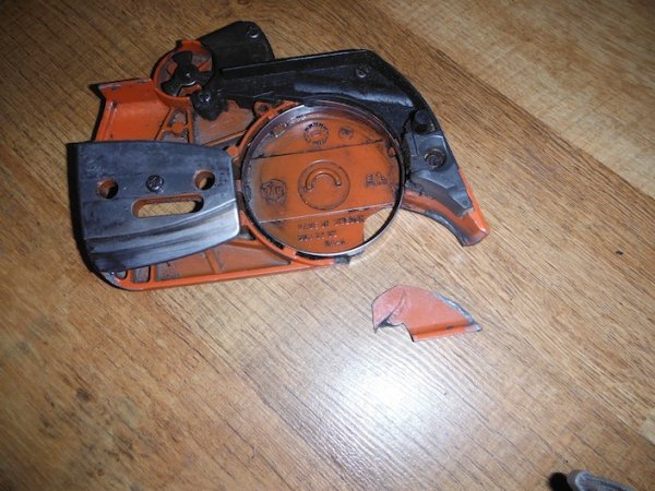

  1. bogydave
    2010 Husqy 359, 20", 3/8" .050
    Dropped it last year on concrete floor & it cracked. epoxy'd it but it broke sometime this year
    Found the piece in the back of the PU today, didn't notice it missing &
    I fell, cut , limed & bucked 8 cord, not sure when it fell off
    Do I need to replace it ?
    Or
    Is it ok to run with part of the brake band exposed?
    Good parts source ?

    I'd replace the sidecover. That's just me...as I see a senerio where a stick or twig could jam in there .

    The brake strap is fully retained but I'd probably replace it. Maybe cut it clean and keep for noodling?

    There's one on ebay auction for $18 total. Go snipe someone! The problem with running missing plastic is the clutch drum spinning and exposed = could be dangerous to fingers. Epoxy and duct tape may work. OR a mending plate with pan heads on clutch side - provided they won't touch clutch drum.

    Mend plate, pop riveted out of the clutch AND chain path, epoxy or JB weld above band and clutch drum.... Gooder...

    Epoxy, strap iron, pop rivets and some orange paint.
    Maybe someone on here has a used part for you cheap, the shipping is what's a kick in the butt, up where you are

    I'd give this a try first. It also buys you time to find a better price. I'd bet there is a Hutzl like aftermarket for that saw much cheaper.
    Have to do something, that outboard clutch is humming along way too fast t

    You could fix it up with fiberglass and resin if you could find a small kit

    If it was cost effective, I'd get one of these and cut twiced in half, then apply to broken clutch cover...
    Now, I know it seems impractical, but it would be slick. X 10....

    :) Lots of good ideas & Yankee engineering. My kinda guys here :)
    Like the fiberglass & bonds idea, couple rivets & a piece of metal to grab on to.
    Had a member here last year, sells wood, the shop he works out of has a bunch
    Of broken saws, (Nate I think)
    May drive over & see what they have.
    Husky dealers might be cheaper too
    Found one at Jack small engine, $52 + shipping
    Don't need it for a while, so I have some time, May - June gonna cut some at moose camp
    Agree , it should be fixed
    (Dreaming) A new MS362 would work too. :rolleyes:
    But then it still needs fixed:zip:
    Will do something before Spring
