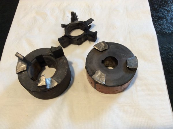

    Coupler came apart pretty easily. The engine side was 7/8" and the pump is 1/2". Instead of the smaller coupler that came on it, I up-sized to the larger one Tractor Supply carries. It barely fits, but it fits. I'm hoping it'll last forever. The one that broke was original and I'd say that splitter is 10-11 years old. Appears the rubber piece wore out a looooong time ago...
    This is the carnage that came off. I'd say it was spent. o_O
