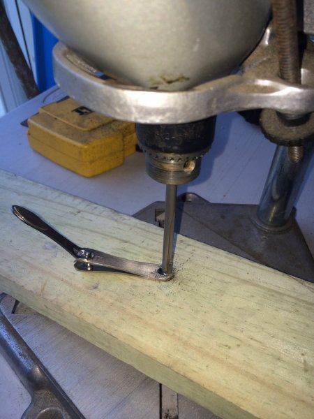

    This Stainless Steel nail clipper is super well made, and unbelievable strong! If I do not have it on my key chain it ends up in the washing machine!
    It was purchased here at Rite Aid for only 2 bucks!
    https://shop.riteaid.com/rite-aid-renewal-nail-clipper-stainless-steel-1-clipper-0349418
    Finally, I pulled out the Big Guns! A $50 Carbide Drill bit and a Drill Stand with constant speed drill ! ! !
    Pic 3 - Final Results - Ta Da!
    It was slow going but it worked! It now fits easily on my Key Ring ! ! ! LOL
    See pics below, click to Enlarge:

    Drilling SS it's all about drill point angle. 135deg angle vs the standard 118 drills so much easier - no reason for a $50 carbide bit;)

    Actually with stainless, it's all about work hardening. The bits will cut longer/better if you take a moderate chip instead of a lighter cut.
    Slow the drill down, push firm and use some kind of oil, preferably a cutting oil.

    Bingo! Start with a good sharp bit, slow(ish) drill speed, steady pressure, plenty of good oil, and keep the chips flying. If the bit isn't cutting well, the piece will work harden in a flash, and then you will have a real bugger of a time getting the rest of the way through! (and you'll end up with a pile of lil metal slivers like in that second pic :whistle: :D)

    I drill stainless steel all the time, being a sign guy, we have to usually drill multiple holes for each letter, so it could be in the 100's for one set of letters.. Sharp , cobalt bits, slow speed, and grease. If we need to drill a 1/4" hole, we predrill with 1/8, then 3/16 then 1/4. I've drilled and tapped 1/2" thick stainless for a sign in Times Square that required 60 3/8 bolts. That was fun.
