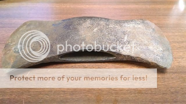

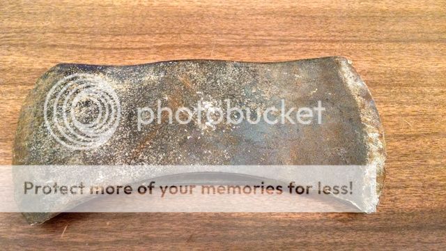

    I was talking to a retired co-worker the other day and noted that I was shopping for a good axe. I'm actually looking for a single bit for driving wedges, but I don't have a double bit either. He stopped by work today and dropped off this:
    He bought it cheap at an auction some time ago and it's been sitting in his shed "taking up space" so he gave it to me. I don't think it's much account as there are no markings anywhere on the head? Going to see what I can make of it anyways. Will update this thread with progress as it unfolds. Have never undertaken a resto project such as this, so should be fun at least.

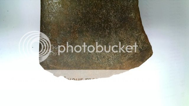

    It's a little beat up and chipped, but looks to have plenty of edge left. I don't think I'll be able to get all the pitting out of it, but I suppose that will give it some character.
    This is the worst of it:

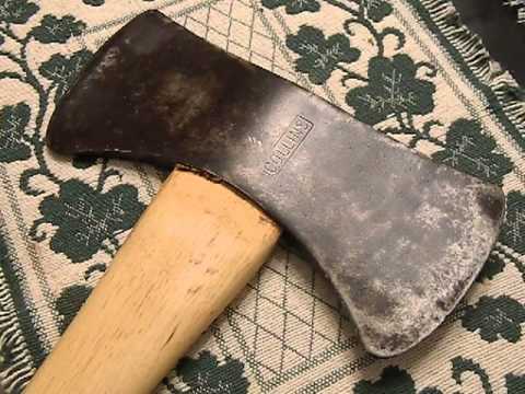

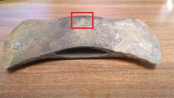

    I think there may part of an engraving mark here:
    Perhaps a Collins? They were one of the first major manufacturers of axes and other hand tools.
    Leadfarmer, milleo, XXL and 1 other person like this.

    I have scrutinized it pretty closely and the pitting has taken any markings? Cant find anything. I will be paying close attention when I clean it up. When I first saw it, was hoping it was an old Plumb 3-2.

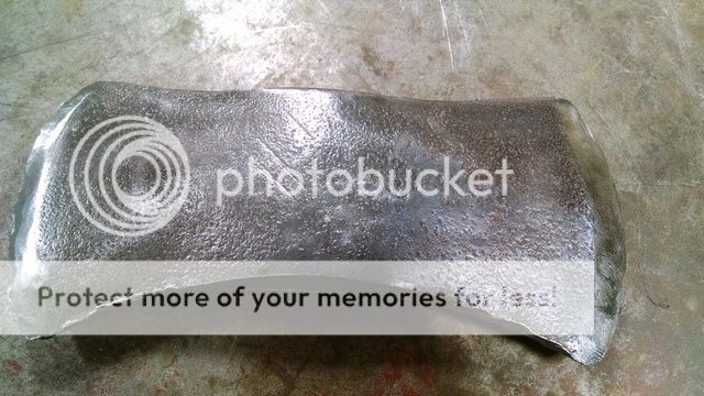

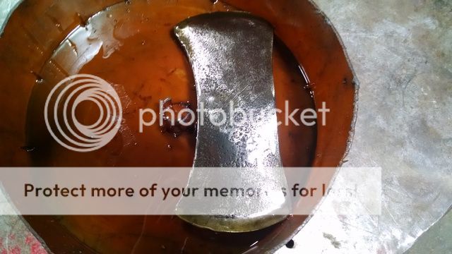

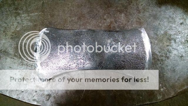

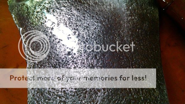

    Breaking news! Started to do initial cleanup this morning. Started with a bench wire wheel, then a die grinder and surface conditioning disc.
    Then decided I am going to let it soak in motor oil all weekend to help bring the remaining rust out of the pits.
    After dousing it with oil I noticed something in the glare coming off the head...
    It's a Plumb!!! :dex::D
    Not sure which model, but am very happy to find that marking!!

    I ran across that when trying to date the stamp mark on the axe. Near as I can tell, it is the earliest of the "rectangle" logos which would date it as early '20s.

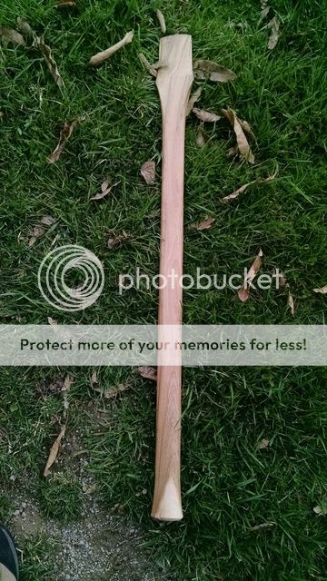

    Stopped at Lowe's on my lunch hour to pick up a new handle and some linseed oil. I am going to strip the varnish and oil the handle. They only had one handle that was heartwood and the grain isn't bad at all. I looked at maybe 8 handles total and most of them the grain was running opposite of what it should.
    I plan to use the linseed oil on a couple other tools I have that the handles are in bad shape on.

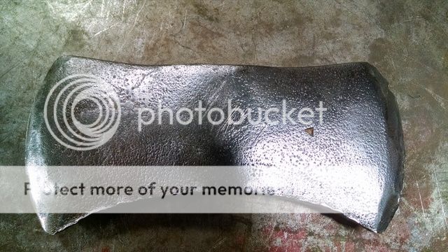

    Trying to get the contour and shape right again after removing the chips. Need to order a round stone. Currently researching proper hanging techniques.

    Finished up sanding the varnish off the handle this evening. Also did my manure fork and a flat shovel handle that were badly weathered. Trying to get my monies worth out of that $6 jug of linseed oil!

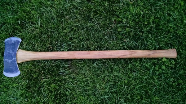

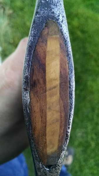

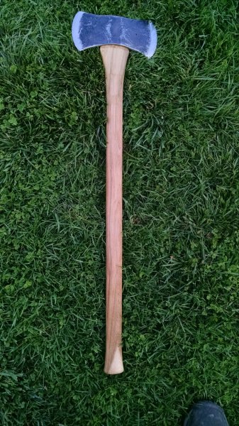

    Well, project is nearing completion. Hung it today. Had not noticed the very uneven kerf cut until I went to shape the handle for the axes eye. Other than that, I'm happy with how it turned out. Touched it with a stone a little, but it needs more work. Should be chopping something with it before long.
