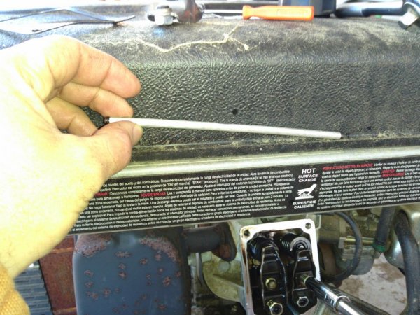

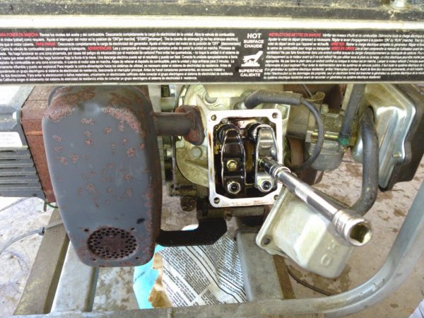

    IMG_20140213_161532_082.jpg IMG_20140213_161318_637.jpg A few years ago the generator was running then all of a sudden stopped. Could not restart it as it felt seized. Pulled the valve cover to see one rocker arm off to the side. Put it back on and ran it a few more hours the next few years till one summer it stopped again. I was welding at buddies house this time. Pulled cover , same thing. Pulled the push rod and it was bananna shaped. We put it in a vice and straighten it and I have run it hours since. I then bought the push rod and rocker arm to replace it. Well like 2 yrs later here we go as I did not get it done before this storm and every the I run it I worry it will fail and I will be repairing g it when I need it. So this time before I put the genny up I finally got to replacing g the parts.
    Here is the old push rod. U can barely see the bend in it. IMG_20140213_161318_637.jpg

    If that was the exhaust side, I would say look for a valve guide working it's way out of the head. But since it's on the intake side, I would have to think the only reason it would drop the push rod would be either excessive amounts of valve lash or the valve is sticking on occasion. A valve seat working it's way loose can do that too.
    How good does it run when it's together? Does it run flawlessly or does it have a little hiccup now and then?

    Waited for the silicone gasket to dry to start it up. no go. All I got was a few back fires.
    Thinking g it was almost like the intake was not closing all the way is how it sounded. Then I remembered that the rods seemed the same length both did notice the rockers were different. I just assumed the new one was a new design or something. As I ordered parts based on the engine tag. Pulled the cover today and noticed the hold down did not nest into the rocker all the was and that the amount t of push looked greater ..maybe?
    Pulled it down again. Compared push rods. They looked same, so I swapped the old rocker back in amd it fired up first pull and ran as smooth as ever.
