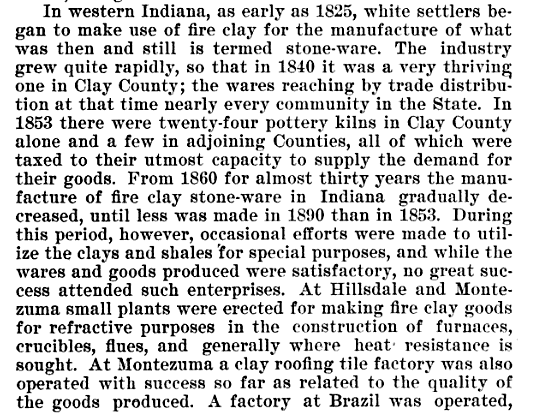

    Believe it or not, some of the best clay in the world can be found right up the road from me. The towns mentioned here are my old stomping grounds:

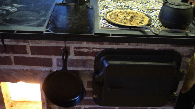

    YES!!! This type of tall smoker is on my "someday" list. Tandoor ovens are built on the same concept. (Check those out too)
    I stumbled on mass/clay cooking while building little brick rocket stoves. I noticed how hot and even the temps of the riser's clay bricks stayed once heated up. I took the riser and built a short little brick box that was uninsulated. Yes, it worked. I smoked country style ribs in it. I usually only need to add additional hot coals in once during a 4-5 hr period. The best part is the way the brick holds temps steadily...it is sick!
    My first, kinda cheesy but it is an example of how clay holds heat: .

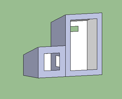

    I don't know if I should have a separate firebox or not. I thought about setting on off to the side with a piece of square tile leading into the rack chamber, then an exhaust port on the rear top.
    Something like this (not to scale)...then I could regulate temp/flow with the door on the firebox...hmm.

    I kind of like his idea of a metal rack. That way there is more flexibility in making adjustments. The rack can always be altered while the bricks can't.
    A perk to bricks is you can build a couple styles without mortar to test them out before you decide what you like best.
