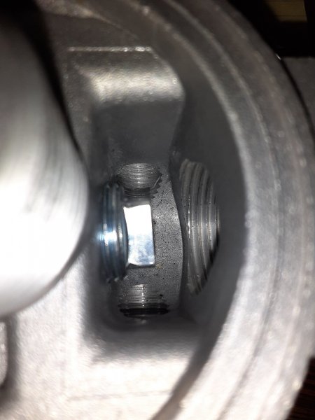

    I figured out what happened. The bypass valve blew out of the filter housing and went through the tank and into the pump. The new pump is already here, so I should be all set to put it back together.
    I called the filter head mfg (cross) and they said they had never heard of that happening. I have found a few instances of it happening on various firewood forums.
    I got the flow/pressure data for the filter and I plan on making an orifice to put in place of the bypass valve to force at least some of the fluid through the filter. I am NOT taking a chance on another valve failing. I will put a pressure gauge on the filter so I can tell what is going on and adjust the orifice size if needed.

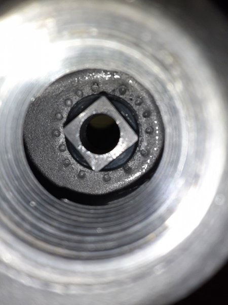

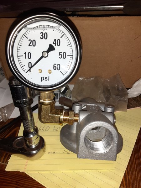

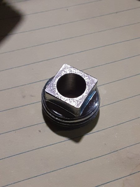

    I came up with several ideas for making the orifice. I didn't want anything that would come loose. I thought about making an insert that would be retained with an o-ring, but if the o-ring gave out it could fall into the filter. I also considered a pressed in piece, because I have a shop press and a lathe. I finally decided to just measure the hole so I knew what I was working with. Turns out it was almost the perfect size for a 3/8 pipe plug.
    I grabbed a pipe plug and one of my taps and it was real close but it worked. I tapped the hole so the plug would screw most of the way in and then put the plug in the lathe. I bored a 5/16" hole in it and trimmed both ends and chamfered the back of the hole (the front of the hole is sharp). I left enough head on it to get a good grip with a socket. The threaded end was trimmed back so it would just go through the aluminum casting, but not block the filter outlet. I used a drop of thread locker and screwed the plug in snug. Then I center punched around it to lock it in even tighter.
    I have checked several charts and they all say that a 5/16 hole should be just about right. I can quickly and easily change the orifice if needed.
    I need to get everything put back together and then test it. I'm hoping to do that tomorrow. I used a 60 psi gauge because I don't know the exact flow numbers on this filter or the specifics of the fluid. I am hoping to see around 8 psi when the fluid is warm. Cold start pressure might be 20 psi? That's just a guess. Once I know it works, I can make a shouldered press in piece that will be permanent.

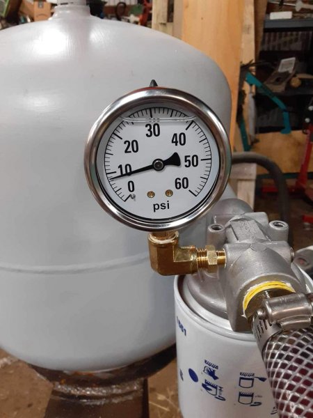

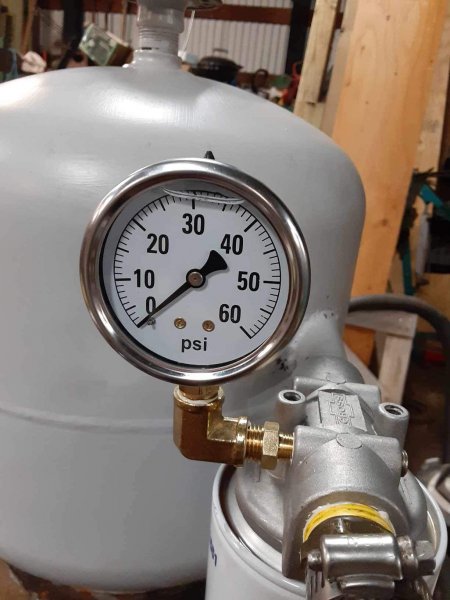

    It's all back together and running. The orifice works great! The temp here is 20-25°, so the fluid wasn't very cold. The filter gauge started out at about 8 lbs and it dropped to zero as the fluid warmed up. I want to do a few really cold starts over the winter and see how high the pressure goes at zero or colder. I can reduce the orifice size, but I don't think I really need to since the filter is flowing better than expected. The oil is getting filtered, so I'm happy.
    The cycle time for a full 24" stroke is about 11 seconds and a 17" stroke is 8 seconds. I set the relief at 2,450 psi and the shift pressure is around 400. I'll fine tune it in the wood. I set the detent pressure to around 100-150 psi. I'm excited to pop some rounds!
