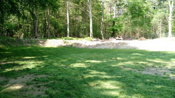

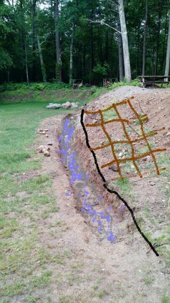

    About summer time last year I started re-shaping my back yard. I am ready to do the retaining wall and have 40+ tons of boulders waiting for me in the side yard. So I laid in the biggest boulder (I reckon 600#+) and a few others and called it a day. However...
    My plan was to dry stack, 4' high, and do a gentle batter tapering back. I did not plan on any fabric or even gravel backfill/ base. The material being held back is extremely sandy. I fear the soil will just erode through the wall, eventually settling all funky and perhaps pushing the wall out without any drainage barrier.
    • Should I use geotextile fabric & gravel?
    Pics do not show my "progress", and sadly those 4 huge boulders I laid are going to have to come out in the event I need the gravel & fabric.

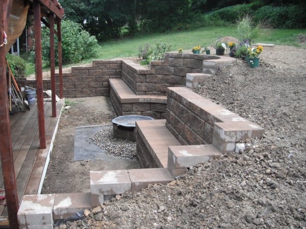

    These are only my thoughts. Pull up any of the well know brand name dry stack wall manufactures web site and download their manual and follow their recommendations. If you can not find it, I have the Keystone manual if you PM me your email.
    I know that they are not typical retaining wall block but the same hydraulics apply to any retaining wall - water behind a wall is bad.... I would do 6 inches of 2b limestone/dolomite/or what you have in your area
    [​IMG] in the base tamped very well with an inch of manufactured lime stone (almost like a heavy sand) on the top and tamp again. The 2b stone can be use for the back fill also. Do not use any kind of round gravel. 1st layer of stone and set them with a 4x4 , log and sledge.
    Fabric directly behind the wall- some holes may be large enough for stones to fall out ->drainage pipe at the base of your 2nd layer ->1 ft of stone behind the wall then mesh again- that way the stone does not fill with sand/ silt / dirt. Build the wall up a couple levels, back fill stone , pull the back fabric back over the wall , back fill dirt, pull fabric back off the wall up the hill and repeat until the wall is at height. That way you can manage how much stone you put behind the wall - too much would be just an extra expense. Wall.jpg
    I did these 2 walls. I don't do it for a living but try to do stuff up to spec when I do things.
    We have had some really bad below zero years recently and hard freeze/thaws and no movement on either wall. Forgot to mention - they have 6 ft fabric - it is more expensive but higher grade and much nice to work with.
    Again, these are only my ideas. Hope I was able to help.
