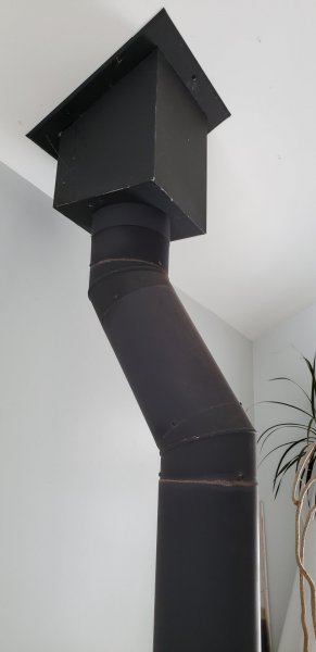

    Anyone have recommendations on a rotary (attach to drill) cleaning system? I have metal pipe with 2 bends so it needs to be flexible. 20190119_123348.jpg

    I have a Sooteater. I've only used it once but it worked pretty good. I think it's one of those products that gets easier to use after a few times. I think the poles could make your bends.

    I have similar bends and I use fiberglass rods and a brush.

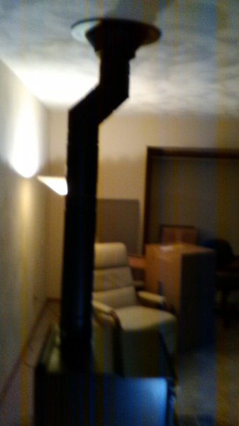

    There is the Soot eater by brand name and there is another with more flexible rods- priced about the same - They are both listed on Flea bay not sure if Amazon has both listed. i have back to back 45.s on mine ( sorry about the poor cell phone pic)

    I have the same type of 45. Soot Eater runs through it easily. Quite honestly though I'm gonna end up buying a chimney brush because it's actually easier for me to clean from the top down with the stove door shut to just let all the stuff fall into there. Bottom up isn't hard but just seems like it gets a lot messier.
