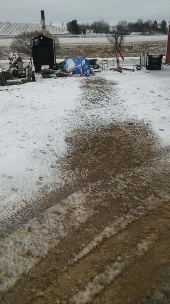

    So I've had a sneaking suspicion of losing heat from my water line, for quite some time now, and tonight I confirmed it, with light snow and warm temperatures, half of the snow directly above the water transfer line(to the best of my knowledge is where it's located) is melted, pretty noticeably, the line coming into the basement looks like a drain tile with two lines (return and supply) with foil wrapped around it and that's it. Which I figured from the start was not enough, my question to everyone here is what can I do?!? To make everything more efficient, is trying blown in insulation worth a shot? Do I need to dig up the line come springand replace it with non homemade line? Help!!!

    Not a bad suggestion, I'll take any help I can get, problem is I need to stop the heat loss a lot sooner and closer, it shouldn't be melting snow that is likely over a foot above it, there's a3-4 foot wide path where you can see is completely different from the snow around it, I'll take pics tomorrow if I remember and is still visible

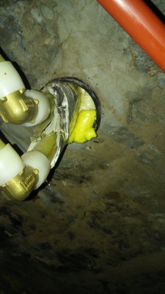

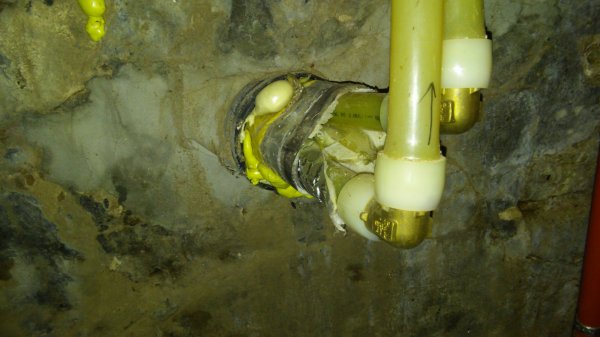

    20151224_110528.jpg 20151224_111118.jpg Y 20151224_111127.jpg Heres a couple pics
    papadave and Horkn like this.

    The spray foam was from me, at best it's probably only 6 inches in, I put it on both ends to stop air from blowing through but you can see what's all melted from losing heat
