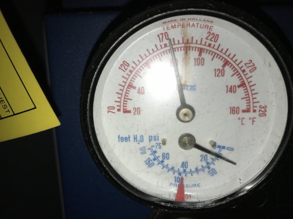

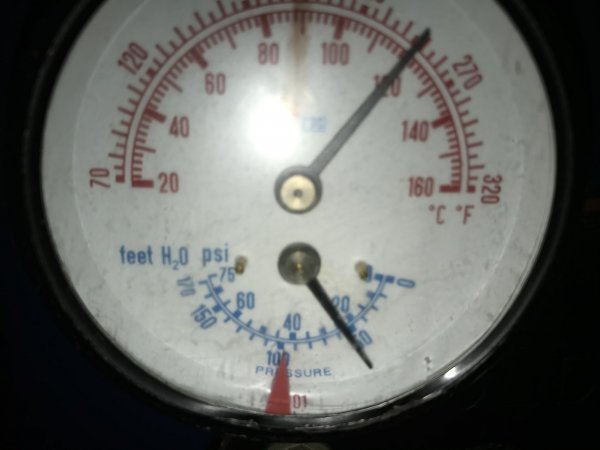

    Think I need help. Noticed my moms oil fired boiler was at just about zero water pressure when running.
    When not running it was about 25 psi.
    I’m guessing that’s not really a good thing. Maybe it’s as easy as a bleeding? She has the cast iron radiators.
    Anyone know anything about these dirty smelly oily things :)

    im doing some searching. I think it’s ok as is. Very dark in the basement I thought it was closer to zero than it is in the pic. Looks ok for a ranch with a dormer.
    I’ll leave the post up tho just in case anyone wants to chime in.

    I just took a closer look at the gauge pics.
    I don't see a problem. Pressures look fine

  10. billb3
    10,318
    53,269
    If the first pic is when he saw/heard the burner fire up it was doing what it was supposed to, raise the temp, especially if a circulator was running. The second pic is probably when or sometime after the burner was told to give it a rest, warm enough.

  14. jo191145
    jo191145
    6,954
    47,841
    Ct
    Think you’ve got it. First pic is running. Somewhere between 10-12 lbs. Not close to zero as I thought.
    Second pic is after running. Higher pressure and higher temp. I assume the gauge and water is picking up the high temps from the water sitting in the boiler. Temp may be a little high. Maybe the circulator should kick on but I’ll leave that for the pros. My concern was the possibility there wasn’t enough water in the system.

  15. TurboDiesel
    16,198
    97,198
    The high temp does seem high.
    Jo asked about pressures though...
    250, if thats a water boiler , is too high.
    190-195 is usually considered the max.
