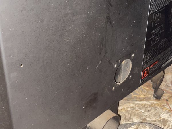

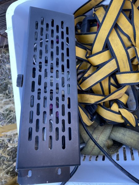

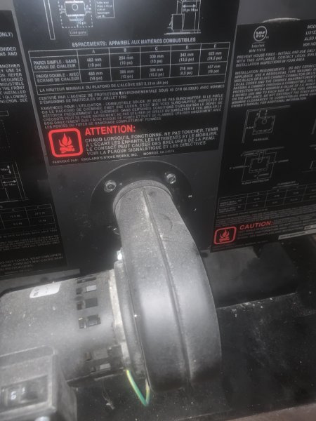

    Just got done cleaning the dust bunnies out of the blower. Here’s the pictures of the blower, NC30 back and the NC13 back. I guess I forgot that the blower sets inside the back panel on the NC30. Which is totally different then the NC13. The 13 does have 4 holes on the outer perimeter which is maybe how the hook up the other blower? Must be a single hole?

    Here is the back of my stove, the only opening and mounts are the small central one. The bolt spacing is 2-1/4” apart. The back of your nc30 definitely looks different than mine :/ E46FF040-EC93-4B52-A84A-18AD9BB22D2D.jpeg D908BC0F-3950-4E51-B15C-AA5FE048CD77.jpeg
