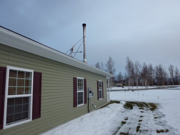

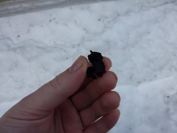

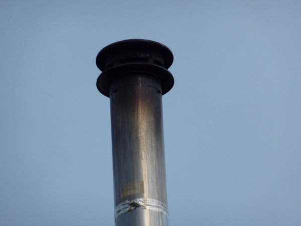

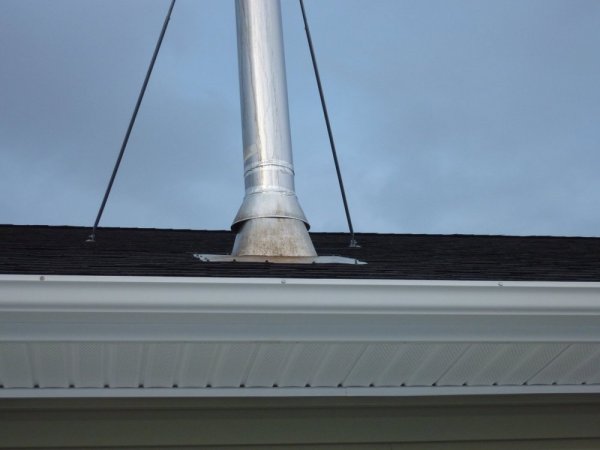

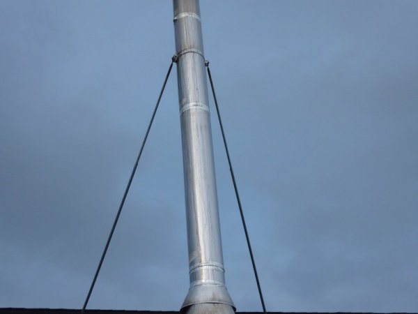

    P1000755.jpg P1000751.jpg P1000750.jpg P1000756.jpg P1000754.jpg P1000753.jpg P1000759.jpg Found the charger for my regular camera, got some photos and put them on the computer. The other photos I took are on my iPhone, but I don't have a working cable to connect it to the computer.
    It did have more of that brownish juice that had run down the chimney but the rains washed some of it it away.
    The creosote chunks, I guess it's falling off the cap? I had some last year and I didn't sweep the chimney.
    I smell a bit of smoke outside at times but I'm not positive it's from me and instead another house. I know my stove will smoke some when I first get a fire going, but once it's burning well it seems to be fairly smoke free.
    Once in a while I will get a kind of smoldering fire, almost creosote smell. Seems like it's when I barely have embers in the stove
  13. jeff_t
    jeff_t
    1,215
    2,798
    SE MI
    Yep, looks just like mine. I even get a couple chunks like that out of the cap. Mine isn't quite that tall, and I twist off the top section when sweeping.
