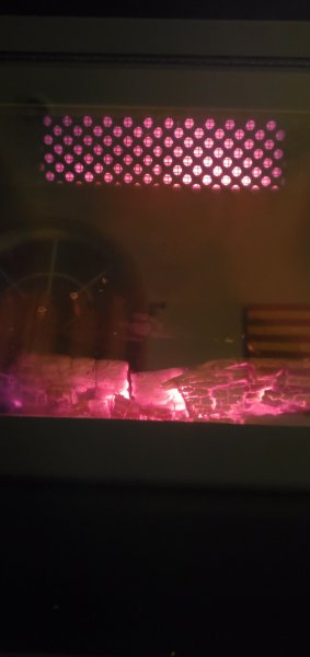

    So, what would be the likelihood that my cat could need replacement after only two full seasons of heating? It seems to go into the active range quickly and stay there throughout the burning of the full load. And, as mentioned earlier, it flows bright orange on the low burn. Would a failing cat emit this random smoke smell, or should the "smell" just go up the chimney?

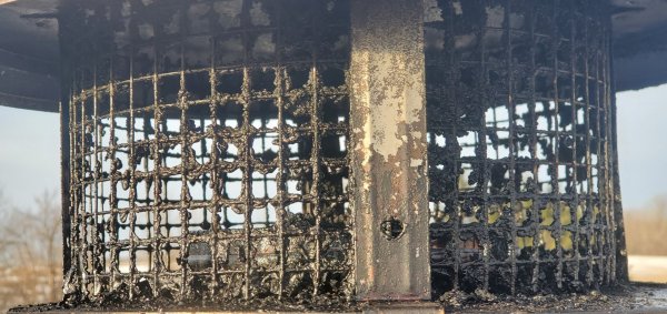

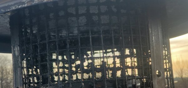

    Just checked the screen. There was some creosote, but definitely not plugged. I brushed it off really good anyways. Just a side note on the smoke smell though, it was noticeable right from the start this season with a freshly cleaned chimney and a clean screen. Early part of the season was mostly low burning fires though.

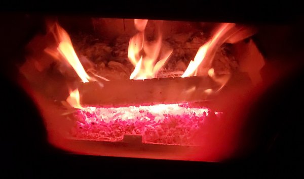

    Most of my burn season is 30-50 degrees outside while it's raining and foggy and gross. I stuff the box full and run it on low for 24 hour cycles. That is this stove's strong point. No need for part loads. The only smoke I get is if I try to reload when the stove is currently burning a load of fuel and smoke rolls out of the loading door.
    The smoke from the BK, any stove, is not just CO2 and water. It's pretty stinky even when everything is clear and right so if it's getting back into your home then you will smell it. It does smell worse when the cat is failing or stalled, almost acrid, but it always has a smell.
    So the biggest issue is that this stove worked perfectly for two years and then suddenly is so bad that your wife wants it gone. Something changed.
    I would ask about your chimney but since this thing worked perfectly before we can rule out a structural issue. Back to what has changed. Fuel quality, other new appliances in the house competing for draft, clogged chimney (verified clean), clogged cat (can happen fast), gasket integrity (but there are other leakpoints that smoke can get out), and of course the catalyst itself is a wear item.
    Yes, it is entirely possible to need a new cat after 2 years if you burn full time. I usually get 2-3 years, 10-12 k hours, the one metal cat didn't even last two years. I dislike metal cats because of this and because of cat clogging. But I can't see how even a failed cat would cause new smells inside the house.
    First thing I'd ask you to try is to not burn so "Aggressively" after cat engagement. Only long enough to get the cat meter up high and the burn obviously well established. Then set the thermostat to your desired long burn setting. If you burn too aggressively at startup the thermostat starts to close the flapper from heat and then when you turn the stat down you are actually closing the thermostat on a raging fire. Chopping the throttle which makes lots of extra smoke. Then, when you do turn it down be sure that the low setting is high enough to keep the cat meter well above the active line. The lowest burn setting is different when outdoor temps are lower.

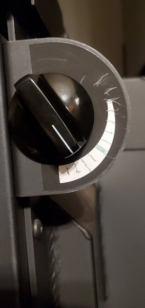

    Now, a couple months into my third year. I'm thinking my average burn is much hotter than you are describing. We have pretty cold winters, even this year already, we've had very cold temps, even below zero several nights, with daytime temps only in the low teens. A low slow burn would never cut it during these temps. I'm almost forced to burn much hotter. Would this wear my cat out sooner. It generally runs on the BK cat stat on top of the stove up in the top 3/4 range (about 5 o'clock)?
    I like how you explain this! I've been getting the new charge of wood burning good, not crazy good, but definitely going. Then, I turn the stat down about 1/8" move at a time with about five minutes between adjustments. This seems to allow the fire to stabilize between adjustments. On cold nights, I will stop my adjustments near the green mark on my stat, or one mark hotter if it's going to be a really cold night. I never dial below the green mark (picture attached). I think I am failing in the area of aggressive startups though. I will have to start dialing the stat back sooner. My cat thermostat generally comes up to temp very quick, so, I generally will close the bypass within five minutes or so of a new fire. Reloads are usually done while cat stat is still in the active range and firebox has good coal bed.

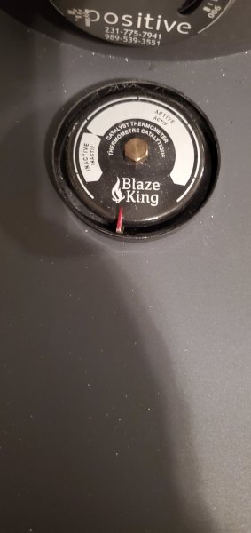

    I just reloaded my stove and brought it up to temp, closed the bypass and started gently dialing back the stat. Within about 20 minutes, the cat stat showed very hot (6 o'clock). This happens quite often. Is the cat over-firing? I wish I knew what the actual temp was as the OEM stat doesn't show actual temps, just active. My fire is "lazy" the stove is not overly hot, but the cat is very high. Is it normal for the cat stat to nearly make a full 360 degree circle when there is only a thin lazy flame in the firebox? Cat is glowing orange and will continue this way for hours.

    Your cat behavior looks perfect to me. Not a dead cat.
    Burning high is not overfiring the cat.
    You have in fact less smoke for it to chew on them if you're burning (smoldering) low. Indeed cats get hotter when burning low.
    So think.all that is behaving normally.
