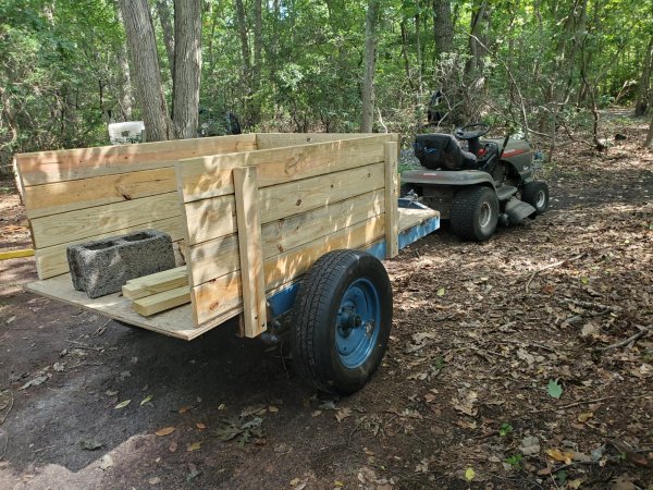

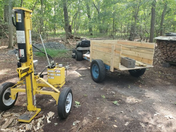

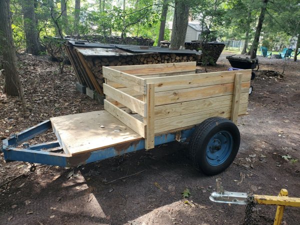

    Finally got around to throwing some rails with some scraps left over from pole barn project and some store bought lumber on that trailer project I had started a few months back. I know it looks a little funky and I stopped short on running the rails on the length of the trailer. That's because as the title indicates this thing is a beast and very very heavy so to much tongue weight and I'll be popping a wheelie. Already used it to unload some wood and move some splits around and what a HUGE difference in cutting down on the workload compared to hauling wood with my much smaller gorilla cart.
    Making my entire wood processing a little easier really helps out and doesn't make scrounging as daunting as it use to be and back to being more fun.

    To bad the axle was not little farther forward. It does look like some pretty heavy frame rails.
    Nice job and like you said it should cut down on some of the workload from what you have been using. I am all for doing what it takes to make things easier.

    In that space at the front you could build a little storage rack for your saws, fuel, tools, wet weather gear, etc.

    Sweet trailer! My .02 thinks you have a really nice set-up. I wouldn’t want the axle farther forward. My wagon has too much area behind he axle and when I load it up real good it ends up unloading the rear tires of my Wheel Horse.:doh:

    That is a nice heavy duty trailer, looks like it was built for a small farm tractor. Set up with gear to the front & wood in the rear that should be handy for sure. Nice job Chuck!

    ReelFaster, looks good. Are you going to fabricate a tailgate of some sort?
    I also like the idea of a tote/footlocker on the front for saw storage. If I had a trailer that would take a storage box, some of my saw stuff would leave the truck box.

    Probably won't do anything with the tailgate just yet, just using around the property to unload rounds and move splits. If I find splits are falling out too much I might just rig something up but so far so good.

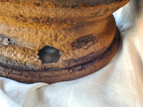

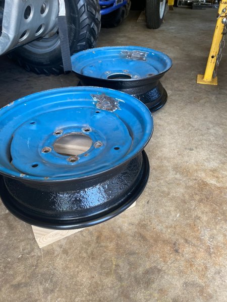

    That's exactly right, someone custom made from a farm tractor (at least that's what I was told). It had farm implement tractor wheels on it with a really odd lug size and spacing. Wheels were in awful shape and one tire kept going flat (had tubes in it). For the life of me I couldn't find wheels that fit it so my brother in law did a bang up job on the wheels, welded patches over the rusted out areas near the valve stem (I put some rubber flashing over top so tube wouldn't catch/tear), blasted the rust of and painted the insides, he went above and beyond on the wheels. Was able to find some used tires free that fit and I slapped some heavy duty tubes in them and I was in business. It's a TANK!

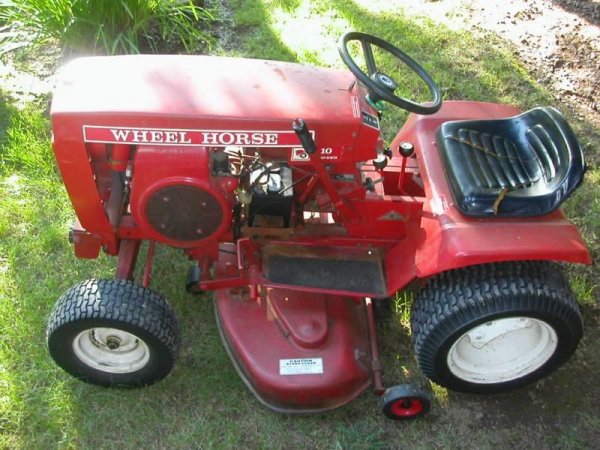

    Not to derail this thread any further, but, this is the tractor I learned to drive as a pup. 1973 model.
