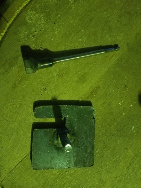

    I just put a new 6" ss liner in my masonry chimney this summer. It was previously lined with an 8x8 clay liner. I wrapped the liner with the insulation blanket. To get it to fit I had to knock the clay liner out. I simply made a tool for it that attached to a corded drill and used chimney brush extension rods.
    Here is a pic of the tool I made. It's a simple drill bit extension with a nut welded on to it that fit the cleaning rods. The other tool was a piece of 3/8" steel that I got from a local welding shop I used to work at. I welded a bolt on to it that fit the rods. It's very crude but worked surprisingly well.

    I never knew such a tool existed but it makes sense. Is the tool as easy to use as it sounds? any chance of damaging the surrounding chimney?

    I've read some things that say you have to be careful to not beat up the masonry. I didn't have any problems but I avoided hitting the bricks as much as possible. Be sure to knock out the clay from the top and work down. I've heard if you go bottom up you're chimney can collapse and I dont think you want that.
    When I did mine, I would knock out 1 or 2 tiles then go down to the bottom and clean the chunks out. It's a lot of up and down but if you dont keep it cleaned up at the bottom it can pile up and get jammed in there.
